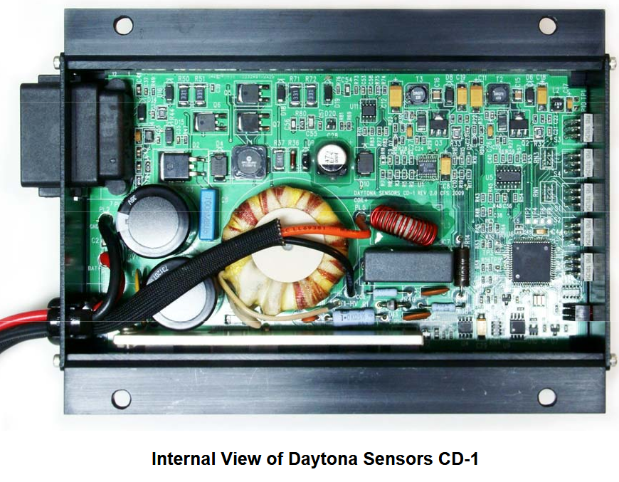

I know you have the MSD already, but the aforementioned Daytona Sensors box is a really quality box. I have one and was turned onto it from the two engine builders with dyno facilities I have used. They both use one on their Dyno’s. They have a picture on their site, comparing the internals to an MSD and Crane box, and looking at the picture, you can see why it would be more durable than the others.

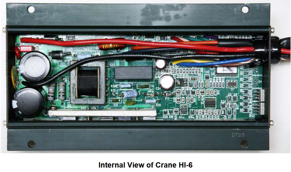

Wow....eye opening!
Daytona CD-1
MSD Digital 6
Crane HI-6
Jebby

As an engineer who has spent the last nearly 4 decades in the product reliability field specifically for electrical devices, what I see here is an example of not modernizing a design to keep up with current technology. It's typical of companies which focus on maximizing short term profit. To do this, rather than investing in new, better, more reliable technologies, they instead buy well known companies with good brands and then cut their product development budgets. They then just milk the existing cash cows until until they die and leave their creditors and workers to deal with the mess left behind.

It (picture) really is amazing Jebby. I love the box. I am using a distributor with no advance mechanism and setting my timing curve with it. Has a lot of really neat features as well.
