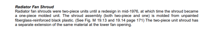

See if this is what you need! It comes from the newly published NCRS 75-77 technical information manual.
File Type: pdf

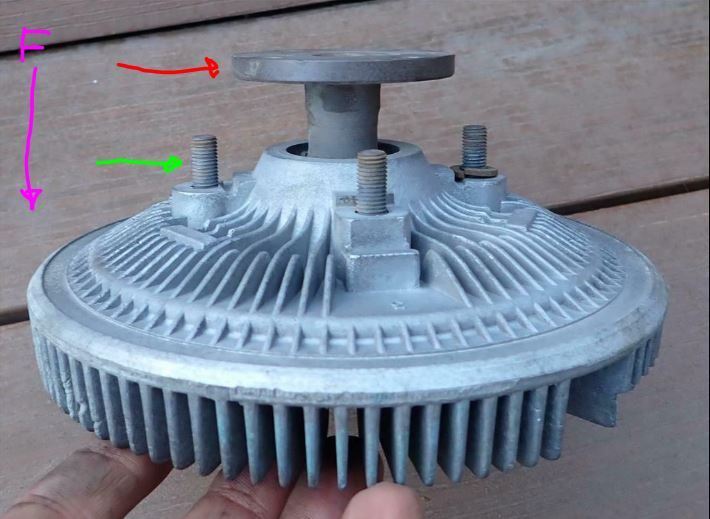

The original fan setup for your '75 had no spacer(s). All you need is the stock fan clutch. The OEM clutch assembly included a shaft which projected the fan blade and fan clutch the proper distance into the radiator shroud. See below:
Red arrow = attachment to water pump Green arrow = attachement to fan blade Pink arrow = front of car
Fan clutch and fan mounting
You did not mention if your car has A/C or not. The correct fan for an A/C car has 7 blades, for a non-A/C car it has 5 blades.
Let me know if you need additional pictures.

good stuff and resources.. i am curious..
it says in PDF 2 piece until mid 76? but replacement in vendor list is one piece for 75? OP got any pics? Is yours one or 2?
and where can i purchase the ncrs info like that pdf has? it will be on my Christmas list

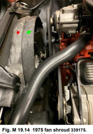

OP's car is a 1975. For 1975, the radiator shroud is one piece. The extension is one piece. They are assembled together as depicted in the pic below:
Red dot = Fan Shroud. Green dot = Fan Shroud Extension
In the link provided earlier, Top Flight P/N's 51798 (shroud) and 51799 (extension) represent the original pieces.. I cannot vouch for the accuracy of their reproductions, though. P/N 29040 is incorrect for a 1975

mine is on order.. great pics..in manual thank you!
ok so forgive my ignorance.. but it says in the PDF 2 for 75? or are they counting the extension which was still early 76?
Correct. They are counting the extension as the second piece.
