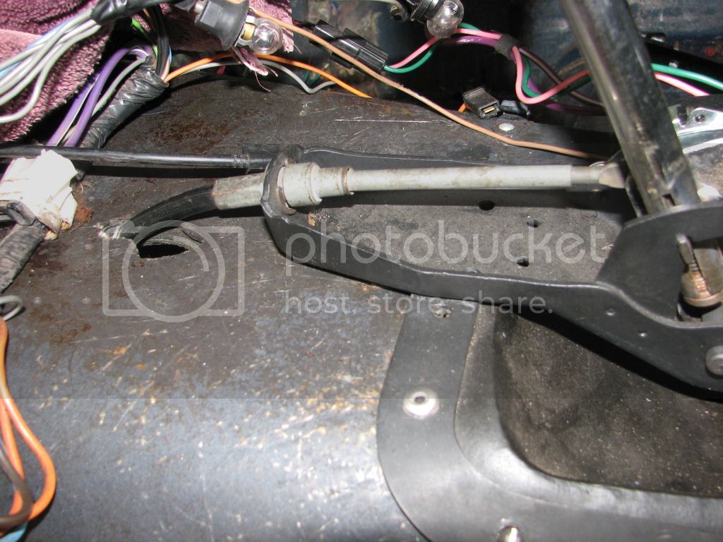

I replaced the shifter linkage in my 1980. I now have some play where the cable is mounted down in front of the shifter.
As you can see from the pictures, the cable now moves forward and back some in the mount. I don't remember the original one having play in it. I will say, I don't really remember how the original fit. I've already tossed it so I can't check it.
Doe the original have play in it like this?
Did I get a bad part?
Have I installed it wrong?
Is there something that wedges in it to take the play out?
I can't seem to get it adjusted right with the play in it. When it goes forward, it goes into park. When I pull it down to drive, I have to go past to 2 and then back up to 3. The play let's it stay in drive and not slip up into neutral.

I had the same issue with my '72 TH400. Ended up using a brake hose clip on the outside of the shift bracket to wedge the cable housing tight.

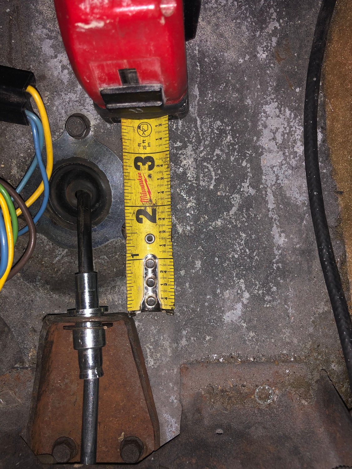

Could you give me the measurement distance from the fordward end of the shifter bracket to the center of that shifter cable "hole"? I'm going to have to make hole in my tunnel so I thought I'd ask.

Slot is way too wide as you've figured out
Here's more or less what they should look like
If you're going to shim, I'd be tempted to shim between the clip and inside of the bracket. That's assuming that the shoulder on the cable is in the right place of course.

It's about 2 1/4". But I wouldn't trust me and who knows if Chevy could have built the same thing twice back then.

There should actually be dimples on the tunnel marking where the center hole and the 3 bolts were to be drilled. Center was 2" IIRC
