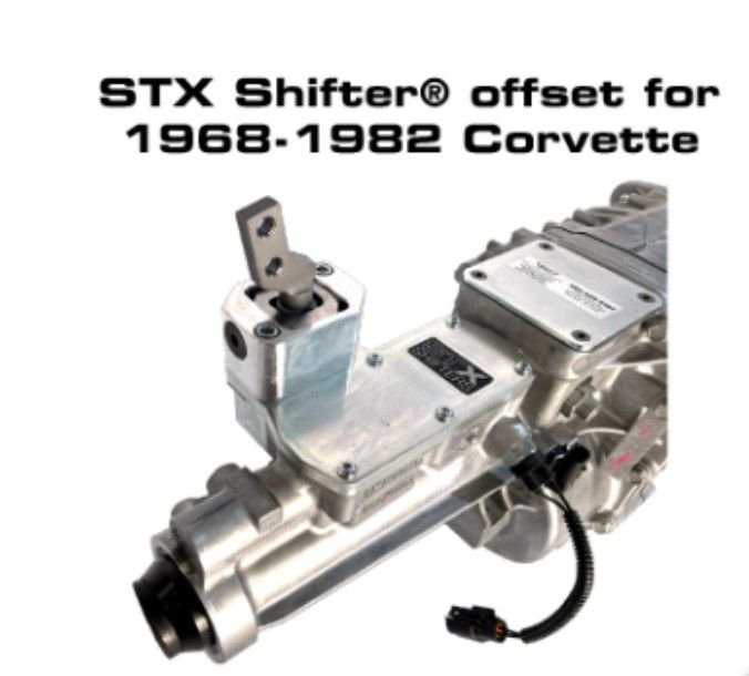

All the Tremec distributors buy the standard trans and manufacture their own shifters, driveshafts and install kits. Here is a shot of the custom made SST C3 shifter, which IMO is the best engineered shifter in the business. It is designed like a Hurst competition Plus, rugged. Others that I have seen include one heavily loaded shifter screw, which can easily come loose. I'm not gonna deal with that.
