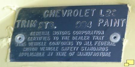

Trim tags used a standard aluminum pop rivet. The VIN were installed with Rosette Rivets. Here is a photo of a 68 Trim tag installed. I use to know what size the rivet head was but can not find that measurement in my files.

Trim tag uses pop rivets. Vin tag uses rosette rivets. If you need those, just go to Ebay. They are available there, but not cheap.

Pop rivets are correct. And if you can get the pin out you can't tell the difference.

Take a small punch or another pop rivet and punch out the remaining stem. That will open up the holes and no one will ever question it.
