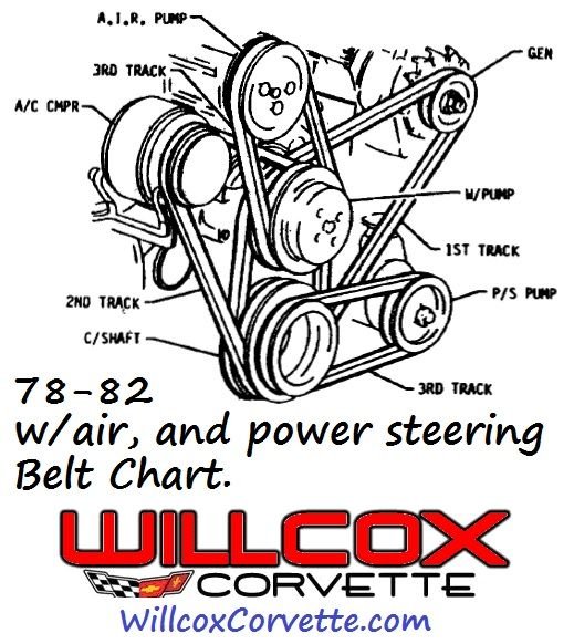

You think you have squealing problems now then just run a single alternator belt...
Drawing 3 is what your L82 with A/C belt and pulley system was originally like.
Drawings 1 & 2 are of NON A/C cars.
Notice belt 9, it is a stretch to fit belt requiring completely different pulley numbers.
Did you use your original pulleys on the crate engine?
These photos are of a 77 L48 NON A/C showing stretch to fit belt 9.
