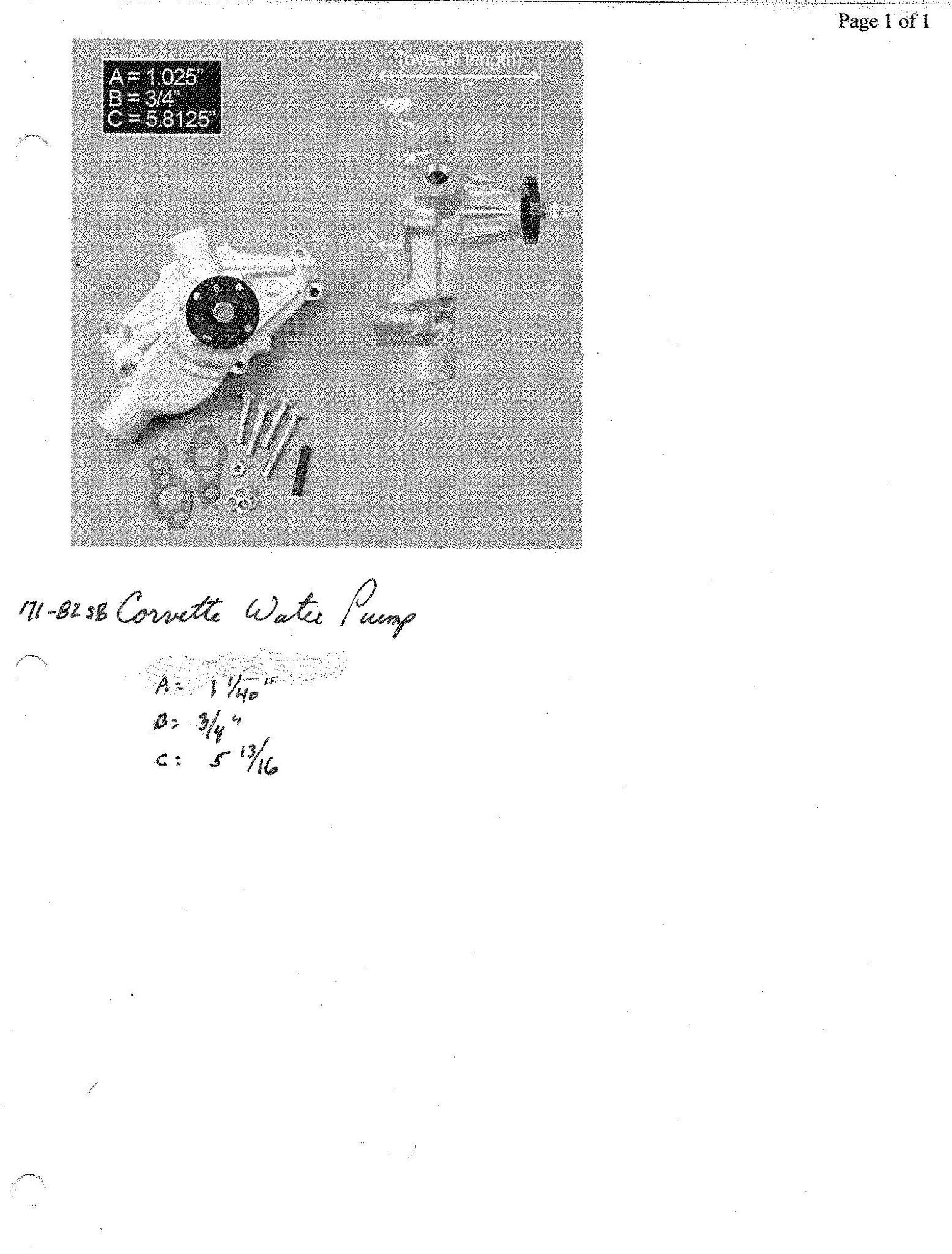

so take a set of calipers to the parts store. if the pump has a 5/8ths shaft diameter, it is the wrong pump. ours is 3/4 inch diameter.
starting in 1971. prior to that it was 5/8”

Default Does this help?
