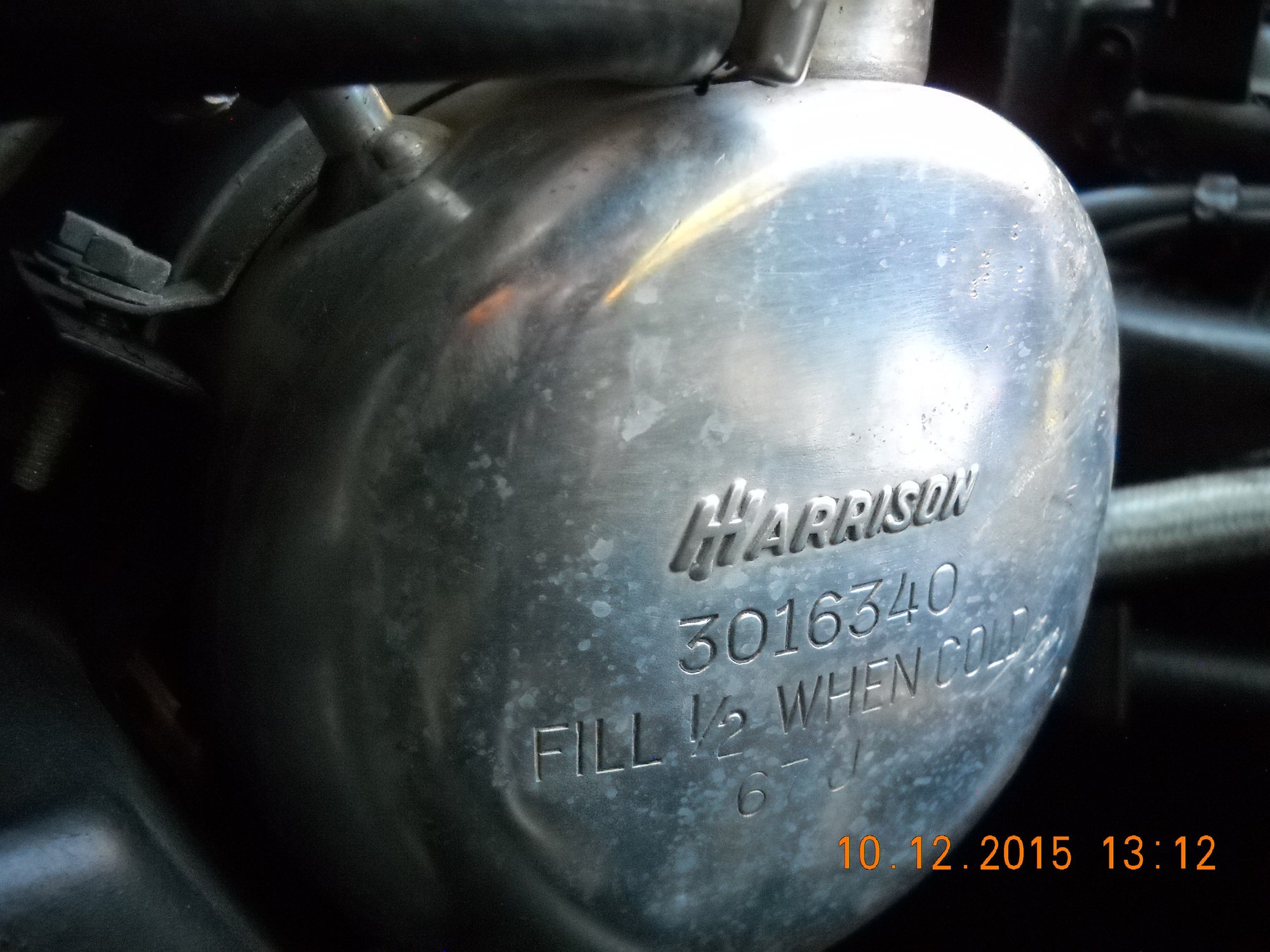

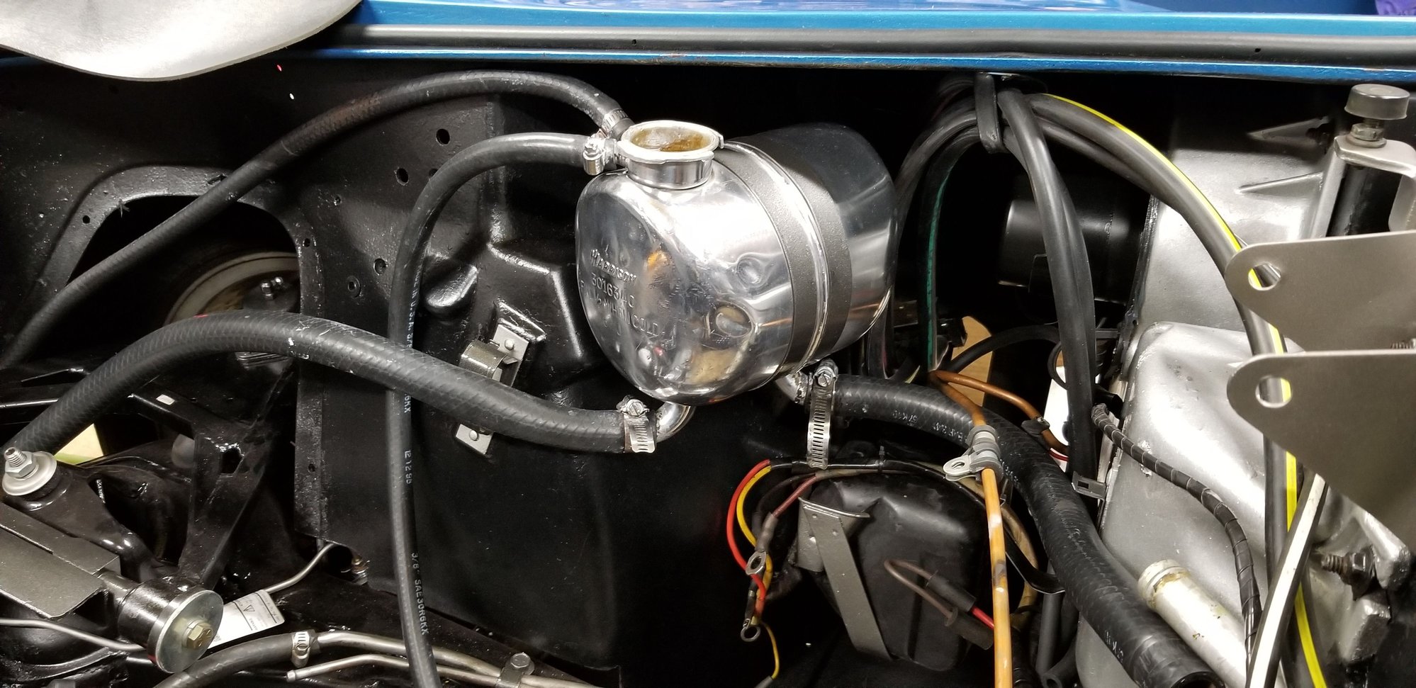

post a pic. If its the big aluminum tank you speak of, that is for the radiator on a small block. IT was an expansion tank, not really an overflow tank. If you are talking about the black plastic tank the bottom of the fender in front of the gills, that is the windshield washer tank.
you can see the wiper washer fluid tank below the aluminum tank with the siver bracket holding it
you may have to zoom in and look behind the spray bottle to where the mount would be...not great pics of the area

Thanks for the pics and response ......I don't know how to post pics ! This is a stock 68...327 car with ac. It had a washer bag on the drivers side inner fender. It also had a white tank pretty much where your aluminum tank is located. That tank had a tube from the cap going along the fender to the radiator fill neck/cap. I'm just going to put a washer tank kinda where your black tank is only a little bit higher. Pretty much where my white tank was ! Thanks for your input !
