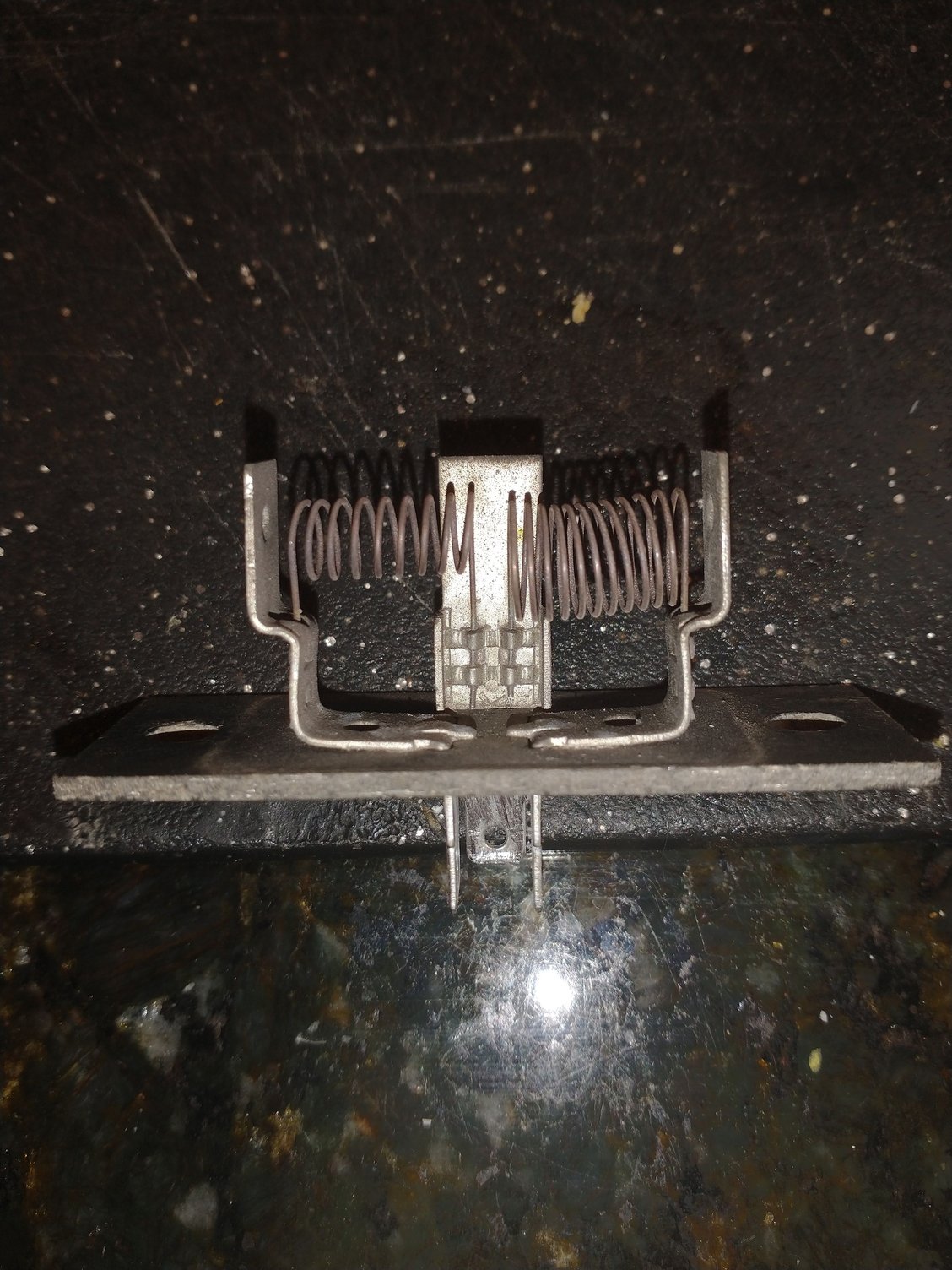

So I found the resistor under the pax side dash. How do you change it?

So,,,,, I got it out. First of all it requires a 5/16 socket. That was hard enough to figure out. Second,,, the resistor wasn't bad. The electrical connectors were just corroded. Sanded them off and the resistor works. Remove the pax side dash so you can get to it from the top and bottom. A stubby ratchet worked perfectly. Now to see how hard it is to install. This is the resistor I am talking about. Not a relay.
It wasn't that bad to install. You can get one hand in the bottom and the other through the top side of the ducting.
