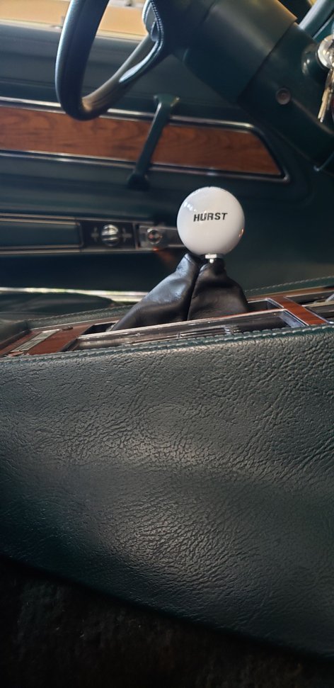

I have 65 GTO going together right now with a 1970 M22- using the factory Hurst shifter.
Like my other 65 and 66 GTO (same factory Hurst shifters), it's a long throw in the factory console.
I found these levers on ebay- and was going to give them a try:
https://www.ebay.com/itm/295176539129
They'd work on a ST-10 as well- unless like you said- the linkage rods aren't long enough to work with upright levers.
Fortunately, the GM A-Bodies don't have that problem.
But there's no reason you couldn't use longer linkage rods from the stock 74-78 Corvettes- or another application (perhaps the A or F-body) on the Corvette.
