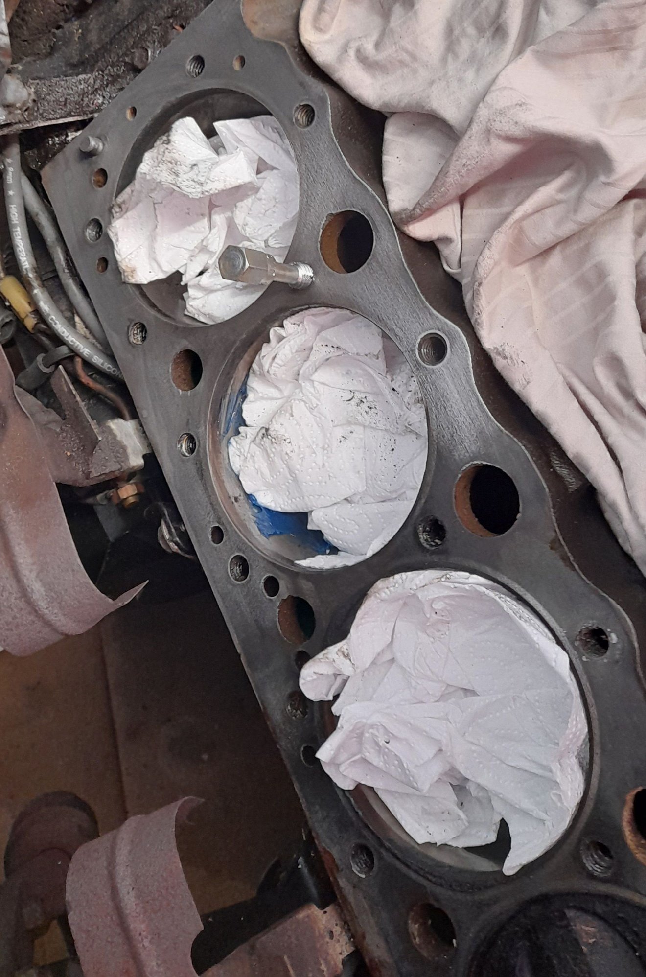

I did mine 5 years ago, And last week.
I pack grease around the edges of the pistons to prevent stuff getting down into the ring land area. then pack the cylinders with paper towels. Scrape and then go over the block with emery. clean with lots of brake cleaner and blow out with tons of compressed air. Turning the engine over by hand will leave the grease and any trapped particles at the top of the bore. Cleaning several times before using brake cleaner and air as a final clean on the bores. Might be a little time consuming, but quicker than pulling the engine.
And note the thread cleaning tool. Gotta clean all those threads so your new sealer has a chance.
