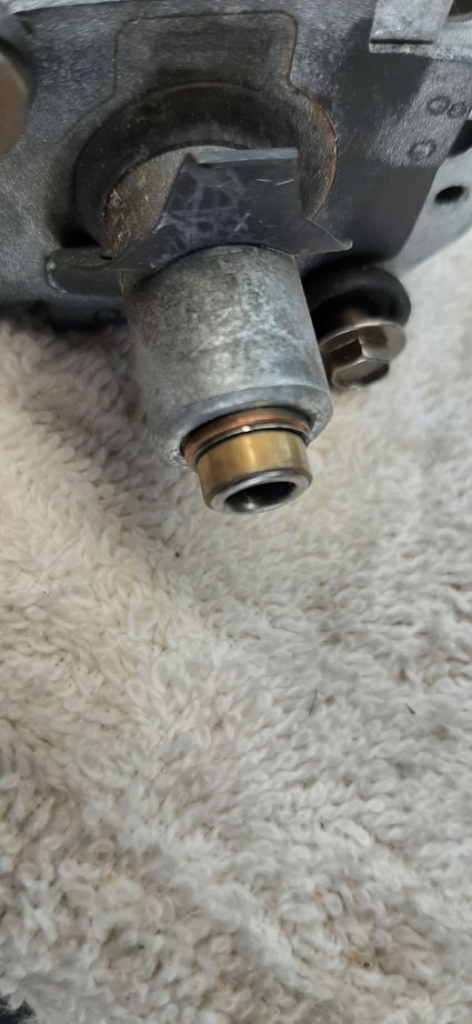

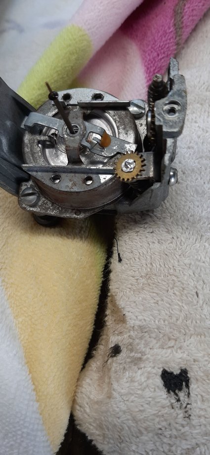

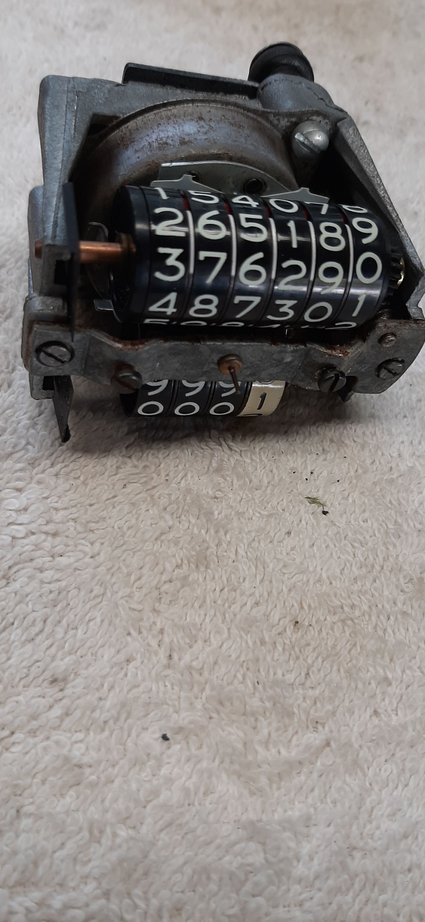

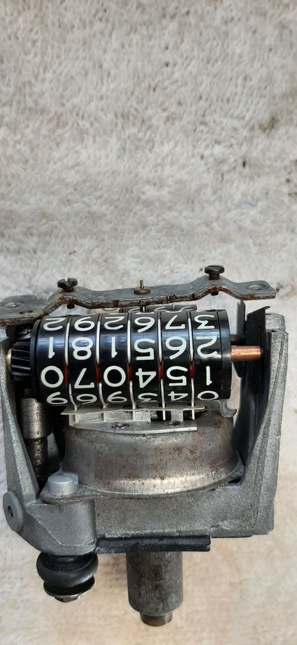

It could just need a good cleaning/flushing out. Mine went absolutely crazy, jumping all over the place. I dismantled it and flushed the stem with alcohol while spinning the shaft with a drill, I cut an allen-wrench and mounted it in the drill. The old graphite ran out of it, and I kept flushing it until I was sure it was good and clean. I sprayed lithium grease into the shaft as I spun it with the drill. I put it all back together and tested it with the drill, works just fine now. Just make sure you take a bunch of pics as you dismantle it, so that you can put it back together correctly.
