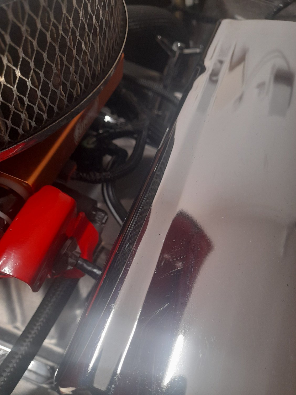

Vacuum lines? One for headlights/HVAC, large one for power brake booster and one small one for distributor vacuum advance.
Not much to clean up really, And I hide nothing under a huge drop base air cleaner.
These 2 at the rear.
And this one which I suppose I could tidy up by T ing off the headlight/HVAC line.
Can't imagine what else you have a vacuum line for if you have eliminated the pollution junk.
