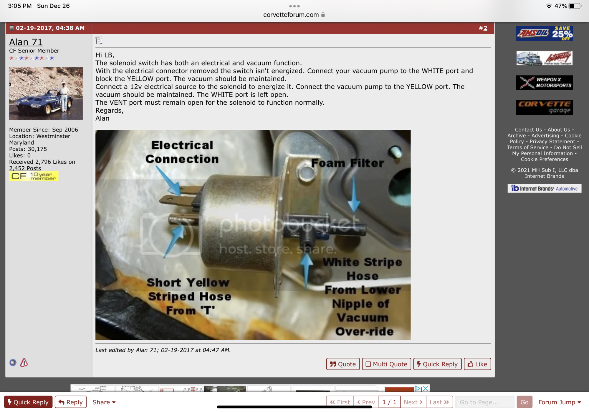

My seinoid switch for wipers vacuum pressure has 3 vacuum connection one on one side and two on the other but I only have to hoses help
part 653150 from corvette central

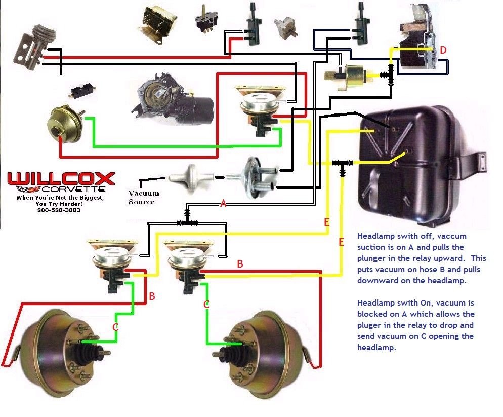

One is a vent. I believe it's the left-pointing horizontal one in the pic. In the diagram below you can see it is supposed to have a foam or felt filter on it.
