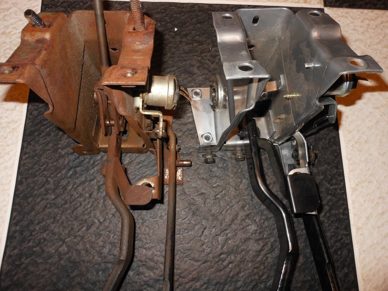

One other thing to consider-
If you are going to move up to 13-14" rotors big brake kit- you need to look at dropping the Master cylinder bore to 7/8s (rather than 1" stock) for manual brakes
For reference for the pedal leverage -here's the pedal set of for manual(left) and power(right)
