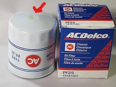

I had the car judged by the NCRS but they hated my oil filter. Lost 5 of 8 points for a PF25 ACDelco oil filter from Corvette Central/Paragon. Bought two both sources sell the same one. Judging manual that is correct for my "CKX" 200 hp 350cuin auto. Anyone know if there is a different source for the filter the NCRS is looking for?

For a 1972 oil filter per the NCRS the originality has 8 points and the Condition 7 points. Your Originality points are divided by 20% for each area (Configuration, Date, Complete , Installation and Finish.
If your filter is a white, red and blue reproduction It Configuration, Date and Finish are not typical.
Configuration issue is the Facet are shorter then originals by 1/3 to 1/2 inch and the bottom flat circle is smaller then originals, then it is dated outside the norm and the finish is typically a painted upper metal ring that should be natural.
With 8 points there would be 1.6 points per area 20% each. So 3 areas of issue would be 4.8 points or 5 points.
A service Blue PF25 would have scored the same.
Since you had 10% or more of the originality available points you would keep all your condition points.
It depends on how much you want to spend for 5 points.
Hope that helps.

It’s hit or miss… You really need to know WHO the judge is and how they judge. Big ask, I know, but that’s really what it comes down to.
I can tell you that if I was still NCRS team leader for 1970-1972, none of that red, white, and blue stuff would fly. The originals were black writing over a white background… Just like every other original oil filter used on a Chevrolet engines during those years. You can’t convince me that Corvettes used a “special” oil filter on their engines and the rest of the car line used something else. The black/white filter itself was unique in that they were only used by the engine plants. It was a way to make sure that the oil/filter change intervals were being met by the customer.

with Stan. But we were not the majority to approve the change to the black and white filter. I for one believed the reason for the black and white was used as Stan pointed out for Warranty. The other was cost a simple black and white finish. The cost for the white, red and blue may be just a few cents per filter, but multiply that by the millions produced as the PF25 was used on so many GM vehicles. Plus the white, red and blue filter looked better when an owner was buying one to be installed at oil change time. Advertising at its best.

What I find is that judges with limited experience default to absolutes and when looking at these perishable items...factory practice was anything but absolute. I could go into detail with fan belts and show how the factory used multiple sources and each used a different code/logo/broadcast code/part number configuration. Some used stamped white printing while others used embossed print styles...bottom line don't get hung up on absolutes!
I can tell you that if I was still NCRS team leader for 1970-1972, none of that red, white, and blue stuff would fly. The originals were black writing over a white background… Just like every other original oil filter used on Chevrolet engines during those years. You can’t convince me that Corvettes used a “special” oil filter on their engines and the rest of the car line used something else. The black/white filter itself was unique in that they were only used by the engine plants. It was a way to make sure that the oil/filter change intervals were being met by the customer.
In our revision of the 73/74 TIMJG (then twenty years old!), we make NO reference to the red, white, and blues but stick to continuity with the 70-72 NCRS TIMJG for oil filters (see attached).
When we got to the revision of the 75-77 TIMJG (also twenty years old), we clarify the transition from the white base to that of blue PF-25s (see attached). We studied engineering documents for both the oil and air filters to draw these conclusions and attempted to nuance the transition periods but worked to avoid absolutes. It makes field judges work harder to get their judging assessment consistent with that which is typical for the build date code.
