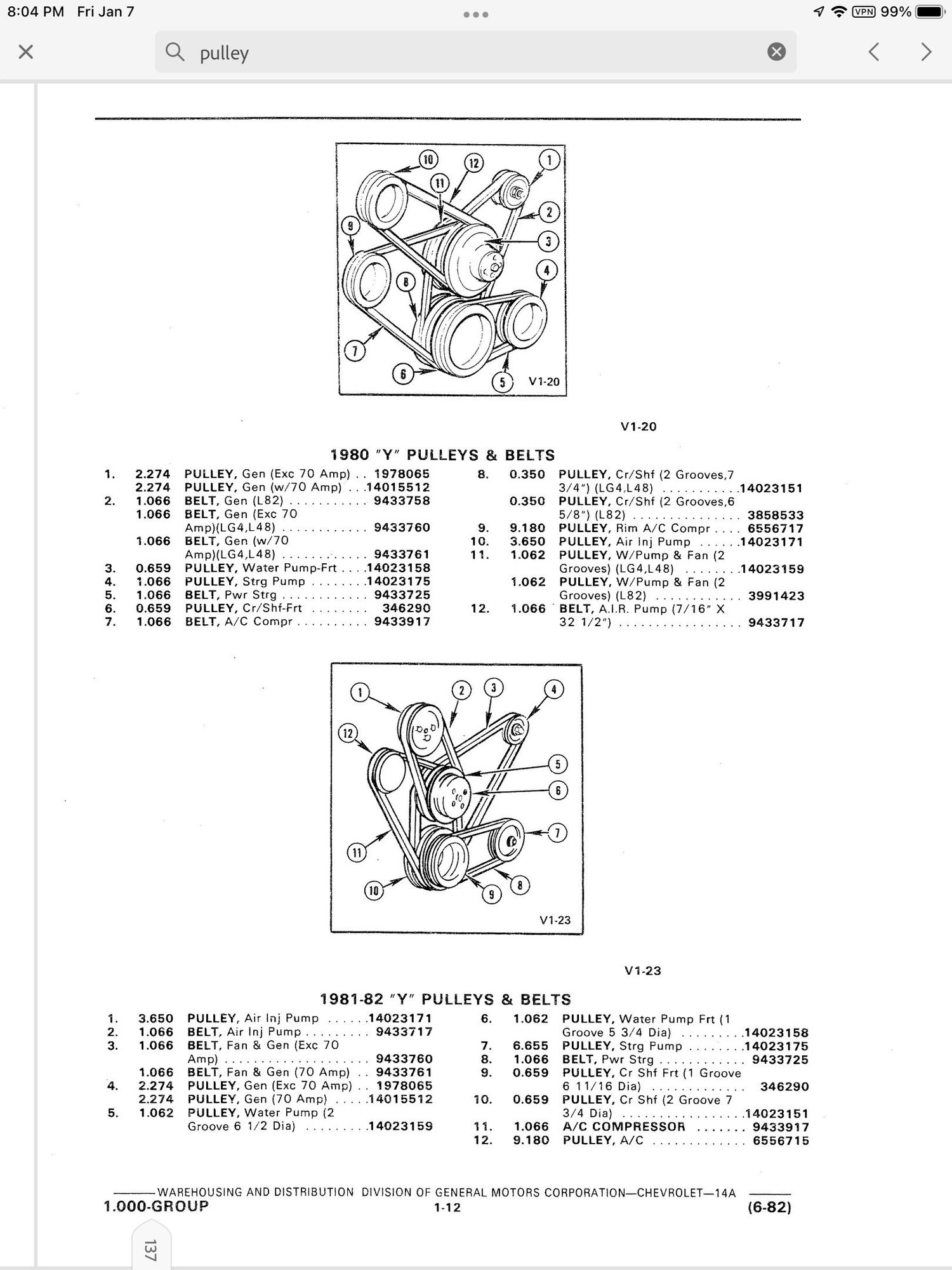

Hello, putting an 82 back together and need belt diagram if anyone has one please.
thanks

download this
post 8 is revised
https://www.corvetteforum.com/forums...ette-lonk.html
