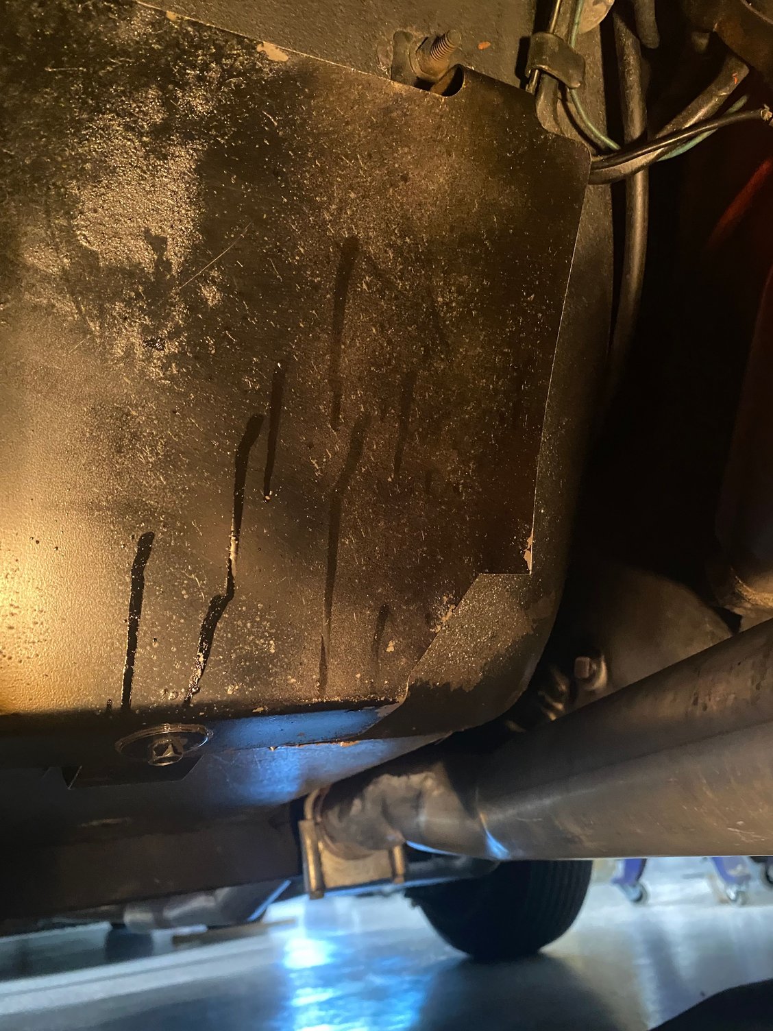

Default Strange Oil Leak
I have a 72 LT-1 that is mostly leak free with one exception. After a 10 mile drive I get a few oil spots on the passenger side heat shield. I have replaced the valve cover gaskets and they show no evidence of leaking and I recently replaced the fuel pump and both gaskets associated with it. I also checked the bolt on the front of the engine I removed and
replaced to hold the fuel pump rod up when I replaced it. I initially thought it was antifreeze leaking from the heater hose at the heater core but I have ruled that out. Any ideas would be appreciated.

Looks like big drops and the location pattern is from being blown back.
Very curious.
The rest looks quite clean.
No drops on the ground?
Could it be power steering fluid?
Maybe a certain position on the steering ram
and some big drops form?
Very curious.
It sometimes leaves one drip after a drive that looks like it may be from the rear main seal. The other things you mention are on the other side of the car.
