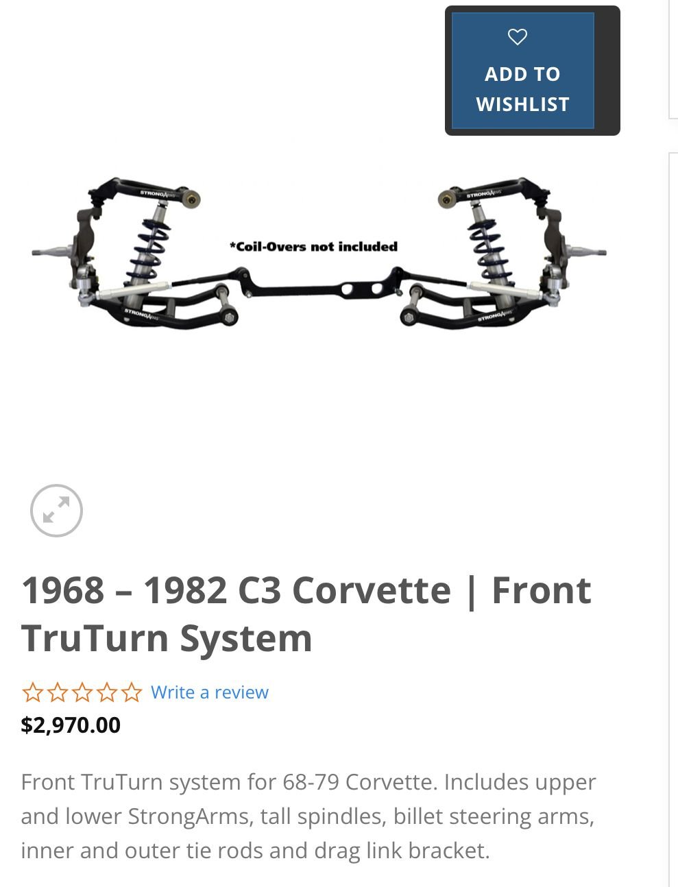

My son and I did a lot of research and decided to go with this. Front and rear with coil overs included. He purchased it and got it delivered but we haven’t got it installed yet though.
https://www.ridetech.com/product/196...stem_11539599/
A lot of good info here:
https://www.corvetteforum.com/forums...r-options.html
Edit: This setup may be more of what you’re looking for.

We went for the coil over system. I just mentioned that the other system may be more in-line with what he’s looking for.
