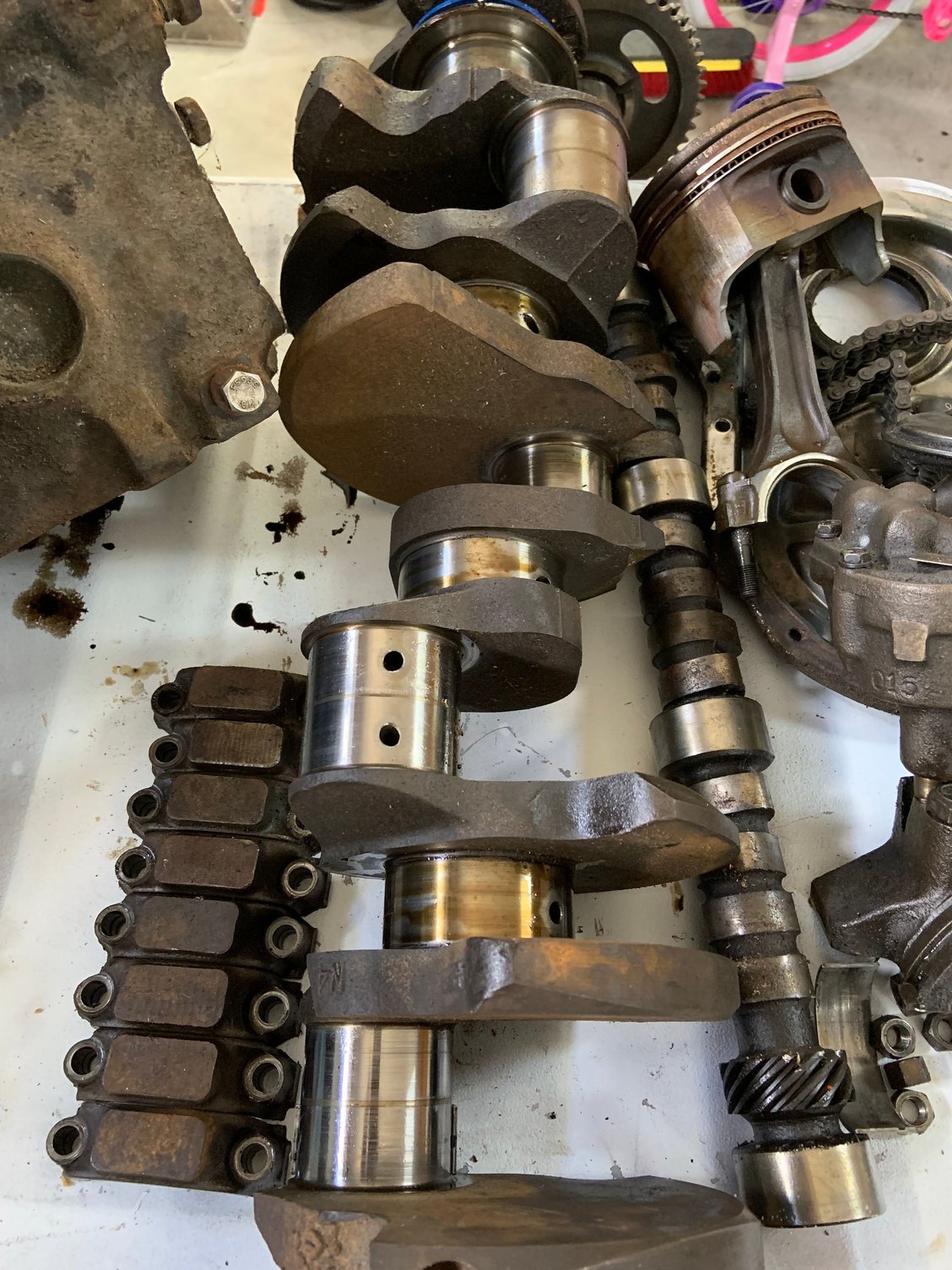

Update
got the motor apart in the garage. Not the best findings. The crank main and rod bearings have a 010 stamped on them. Tells me the crank has been ground 010/010.
And the pistons have a 040 stamped on them. Tells me the bore is 40 over.
Not as good of a find as I thought it was. And it changes my plans.
Not sure if I should try to reuse the crank(it appears in good shape visually, no scores) or just buy a new one, standard size. The point of buying this short block over a bare block was to save money by reusing the crank. I’m just not sure if my goal of 550-600hp would still work with the current crank.
I need to actually measure the bores, but I am fine with a 60 over. Does anyone have any thoughts on 60 over? From what I’ve read that is still plenty safe for big blocks with 600hp tops

Stay at 40 on the bores. Get crank Miked. If good, run it at 10. Post pic of crank. 2 or 4 bolt mains? And we don’t like 20 cut cranks. You cut a crank 10 and you are still in hard metal. Cut 20, you have cut through the surface hardness. Post bore pics too.

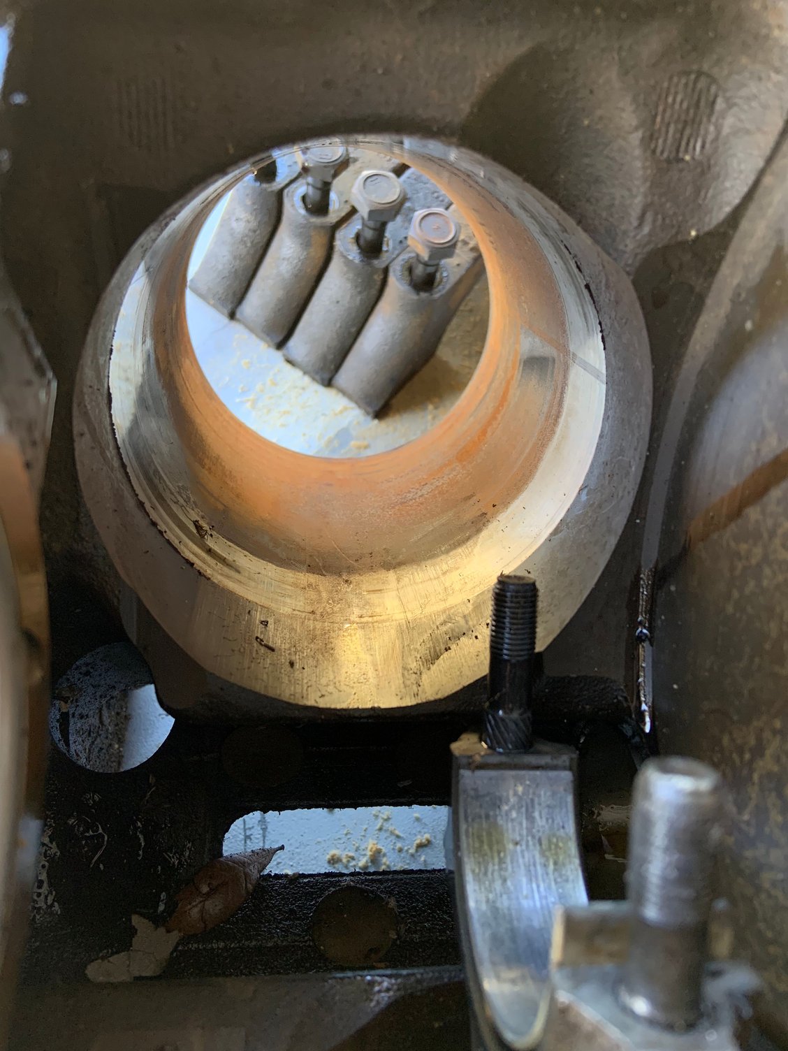

The bores are not the best shape; rust and scratches. the short block was kept outside under a carport for 14 years. I think boring out to 60 over would ensure good fresh metal. Even though it was kept outside I could turn the engine over by hand, it wasn’t seized at all.
The crank, although ground 010/010 appears to be in good shape. All journals pass the fingernail test.

2 bolt cast crank. another option is hone the bores and resell it. if you bore it to 60 and gonna replace crank and pistons, think 496.
