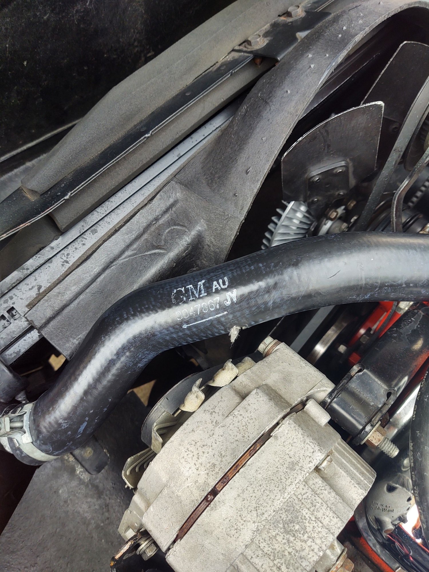

I got new tires and can actually do a 1st gear WOT pull, but I just cut my second upper radiator hose. I'm thinking I need motor mounts as there seems to be plenty of clearance between the hose and alternator. I've used the Polyurethane mounts before on a 72 Monte Carlo with a 502, but not sure how they work on a Corvette. The engine is mostly stock 400hp 427, with a 268 cam. Will there be too much vibration with the Polyurethane? Which would you guys recommend?

Go old school and use a chain to limit how far the motor can move, with just enough slack that it doesn’t transmit vibration.
There was another old school method of drilling through the mount and tapping only the frame side of the mount and installing a bolt with a little bit of clearance under the head to allow vibes but limit movement. I seem to remember the head of said bolt would fit inside the freeze plug so no worries on clearance. Can’t recall if this works in Vette mounts though.
Edit: I also remembered there is a “safety” version of the motor mount that has part of the block side in a t-shape bent up over the frame side to act as a limiter. But I think those didn’t work with spark plug shields.

Super dumb question. Is that the OE radiator? What kinda shape is the core support and the radiator support pads on the bottom look like? Could be that the radiator is bouncing downward just as much as the motor is coming upward. Or it could be a fitment issue for a non OE radiator. Could be the mounts but figured I would throw it out there to make sure you look at this angle as well to make sure you cover the problem.

Thanks, its a Dwitt's rad - pretty sure it's secured but I will double check.
