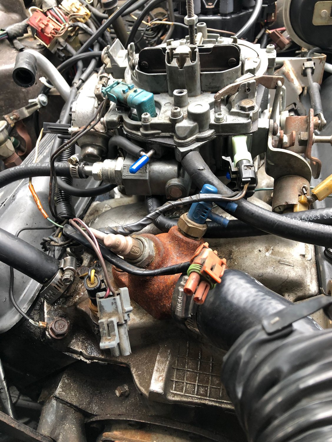

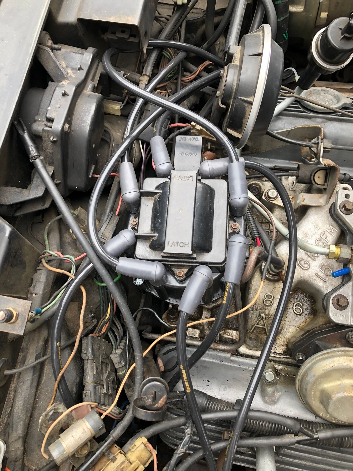

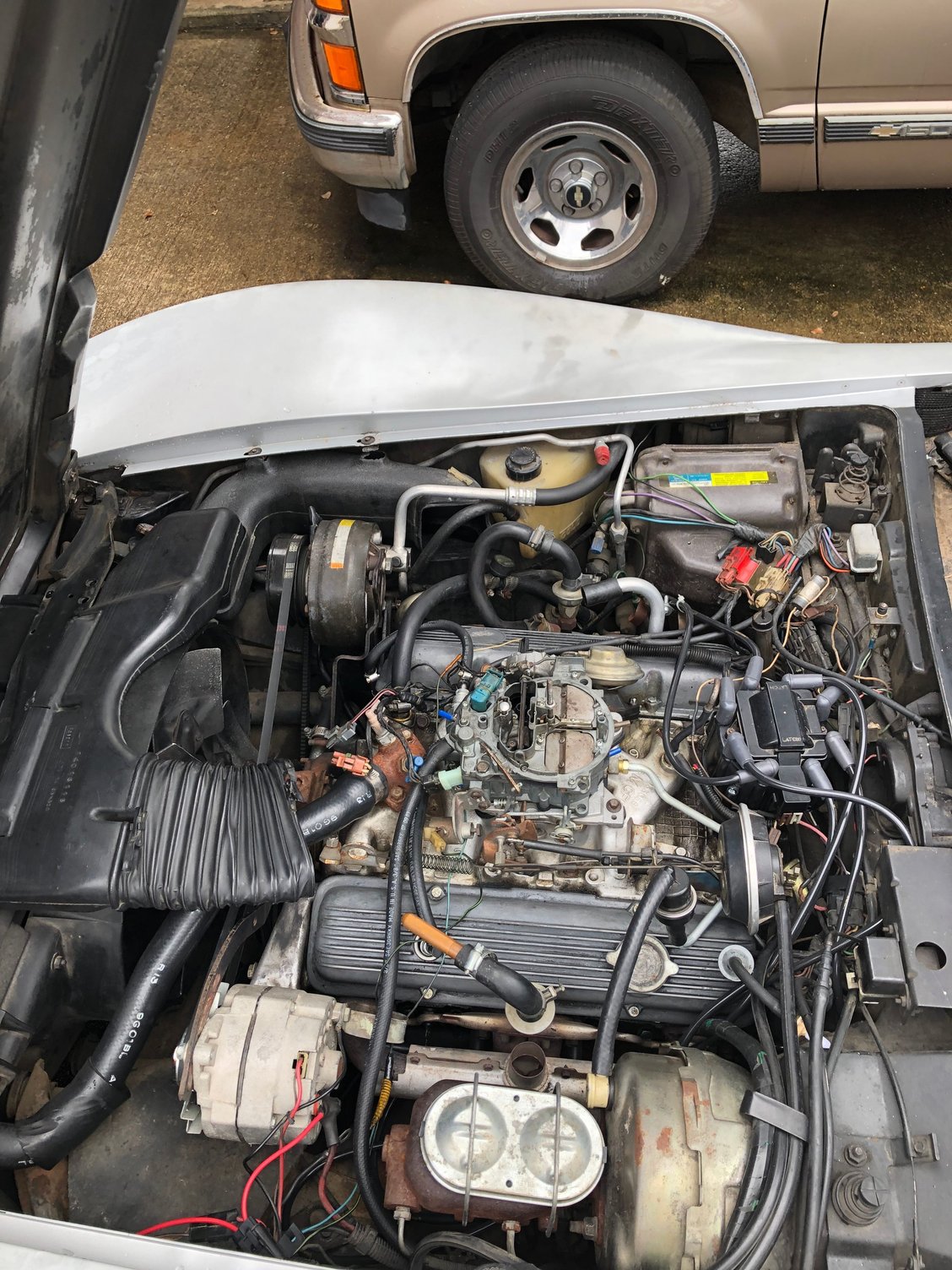

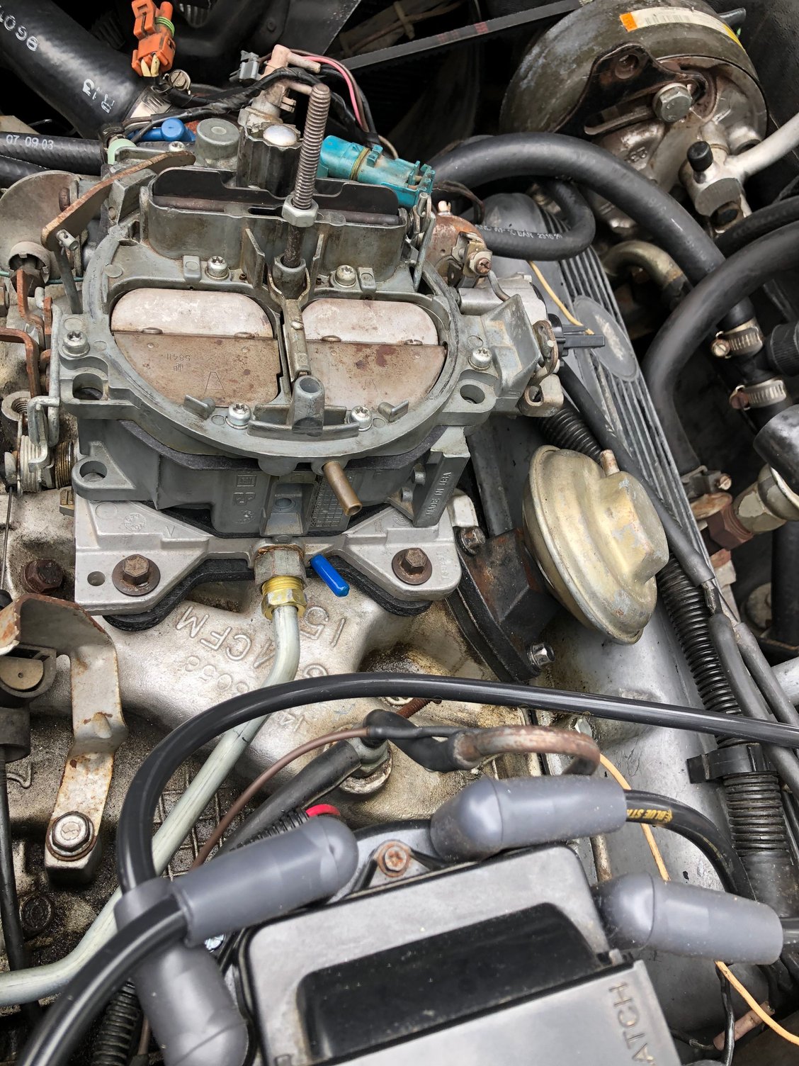

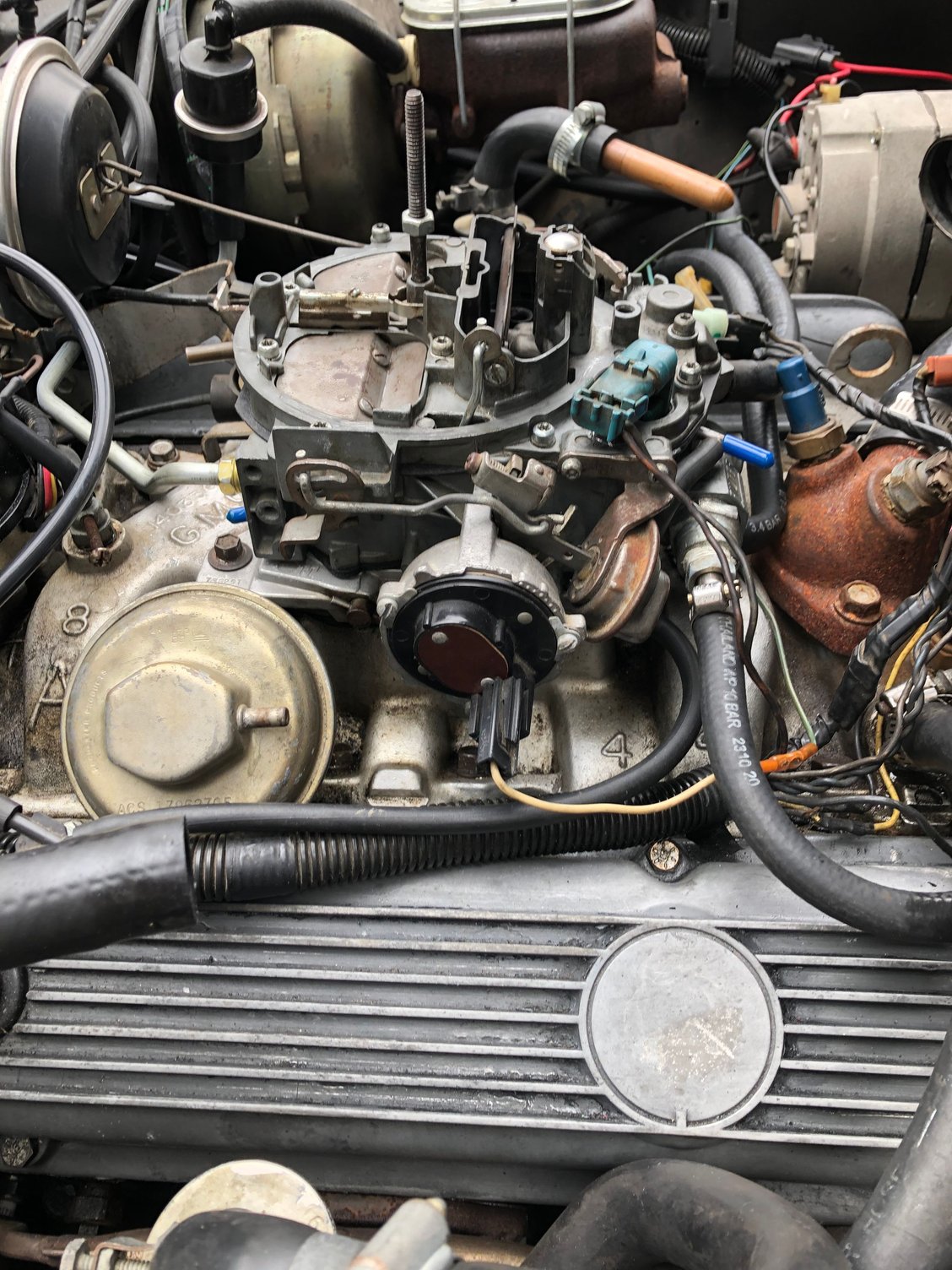

Yes it is definitely a 81 Rochester Quad. It’s a solid carb but I believe I’ve just adjusted the float wrong (old was punctured by metering rods by previous rebuilder…) so no biggie. Here are some pictures under the hood. Warning: it’s not pretty but it’s a very solid car.

Thanks for the update and photos! Here are some quick thoughts/questions. Hopefully others will add theirs as well.
Your choke is open. Was the engine recently run and warm in this photo?
Can you get the part number off of the distributor, or check to see if it is a 4 wire, but missing a vacuum advance, or the 81's 7 wire HEI, which means your entire ECM-based system is likely intact?
You have a lot of open vacuum ports. I'm sure some were from removing the air cleaner, but notable are:
  • Port on carb (for fuel vapor system perhaps?)
  • EGR valve. Also, it looks like there is a blocking plate underneath the valve. Can you confirm that it has been disabled?
  • TVS switches on the water neck
The zip-tied distributor wires can cause cross-talk. It is better to use comb separators, and/or a wire loam.
That rubber hose line on the pressurized side (between fuel pump and carb) is a fire hazard.
If your ECM is really missing (it should be behind the seats), the carb and especially the timing will not be optimized, and could explain a lot of poor running. I know what I would with this car, but it is your car, so hopefully the Forum can help you get you running well, whatever path you choose.
