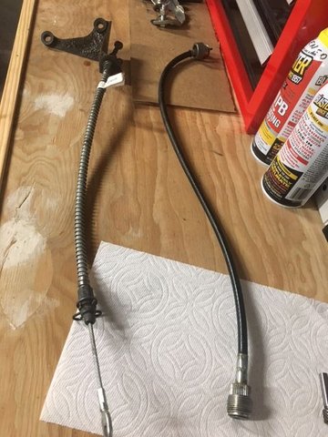

I am tearing down my '73 big block TH400 coupe for a body off restomod project.
I will be removing the TH400 and replacing it with a TKO600 manual.
I found a steel cable in a steel braided housing that runs from a bracket attached to the steering column and runs to the shift linkage on the drivers side of the TH400 transmission.
Can someone tell me what this cable is for and if I will need it to attach to my TKO600 manual transmission?
I attached a photo of the cable.
The black cable in the photo is the speedometer cable.
Thanks

interlock cable so that you cannot move the shifter out of park unless the key is turned.

I think it's the other way around: can't remove the key unless the trans is in park or reverse for a manual, trans. No, you don't need to re install it. Just secure the lever on the column in the "up" position. I used safety wire to secure mine.

I called Ididit and they told me the cable is not needed with their column and a manual transmission.

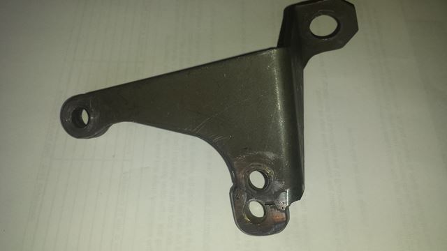

Guys, I have upgraded to a 700R4 and am having similar issues with my steering lock cable. The original pan bracket no longer is compatible. Shiftworks Inc,, who usually makes all things needed to upgrade transmissions in C3’s, appears to have everything EXCEPT this particular bracket, I would like to maintain this feature on my Vette rather than disconnect. Do you know of anyone making this bracket?
1976 Vette
Yeah, i did when i did my swap into my 72...
made a paper template and just welded a small block onto the end of the original bracket

if it's a TH400, then i would assume that the brackets would be the same.
well my 72 was originally a TH400 car, then I swapped in a 700R4 and just welded the little bit extra on existing bracket as pictured above
