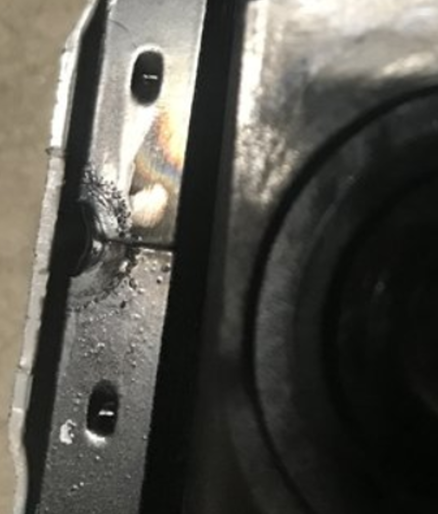

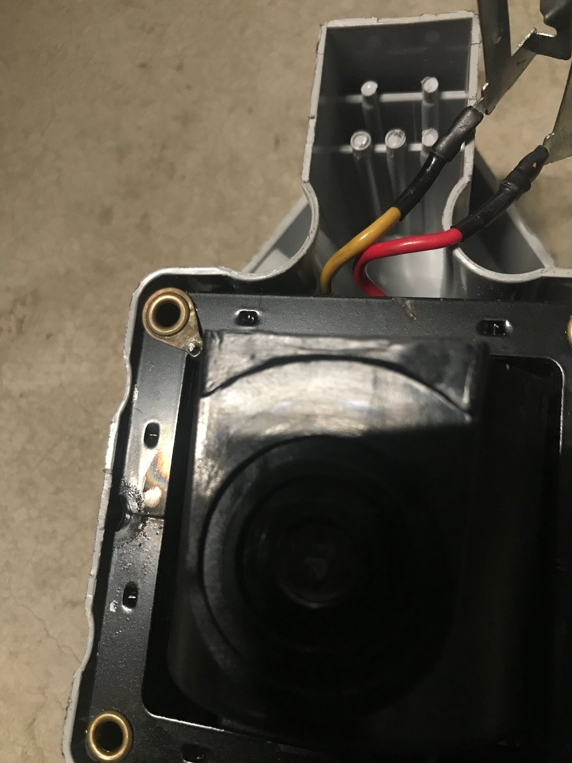

Well, after 2 weeks of checking everything possible to figure out my intermittent backfires, it turns out my 3 month old “premium” coil went bad. It is an Acccel HEI Super Coil part num 140003. This is really disappointing, as it is the first accel part I’ve bought that has failed so soon. I payed a premium for what I thought was a premium part. Oh well, it happens.
Anyways what do you think is wrong with it? Internal ground failure? My symptoms were single, loud backfires out the carb under any acceleration besides EXTREMELY light acceleration. This would happen while driving or while I pulled the throttl with my hand. Any ideas?
here is a pic of some minor discoloration under the coil. On the left and that mark on upper part has some too

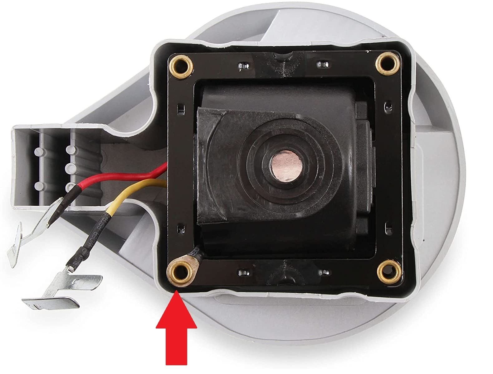

That brass eyelet. was there a black wire at one time soldiered to it?
I see a hint of melted something at the end?

**** poor way to ground a high energy coil if you ask me...
Bottom side?

yes that is where the ground is. It doesnt look melted, but it definitely doesnt look like it did new.

It's hard to tell, but I blew the pic up in the discolored area and it might be suspect to arcing a little which would more than likely cause a misfire? Look at the carbon to the right of that as well, that looks like it was tracking? Again, hard to tell for sure. Replace it a DUI coil and find out. GL
