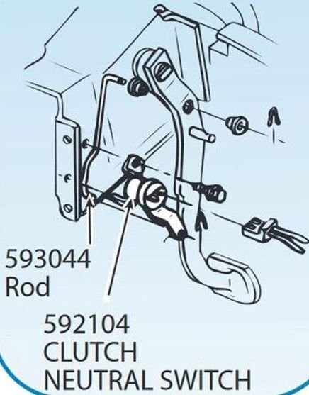

After checking all the above investigate the switch on the clutch pedal, if it is not working correctly, the starter will not turn, even if the transmission is in neutral. An ohm meter is an easy way to test the switch without removal. Use Google to see pictures of it’s location on the clutch arm/bracket.

4. Check Switch on clutch pedal -
5. Check Ignition switch
Any help on how to test the clutch and ignition switch would be helpful.

I believe the clutch seitch is a simple on/off.
Just set your DVM to Ohms and check the resistance. With the switch in one position it should be near 0 Ohms, and in the max other positon it should be infinite Ohms.
While a sketchy switch could momentarily test ok, you could also hot wire the connector (car in neutral, ebrake on) off the switch to see if your problem persists.
