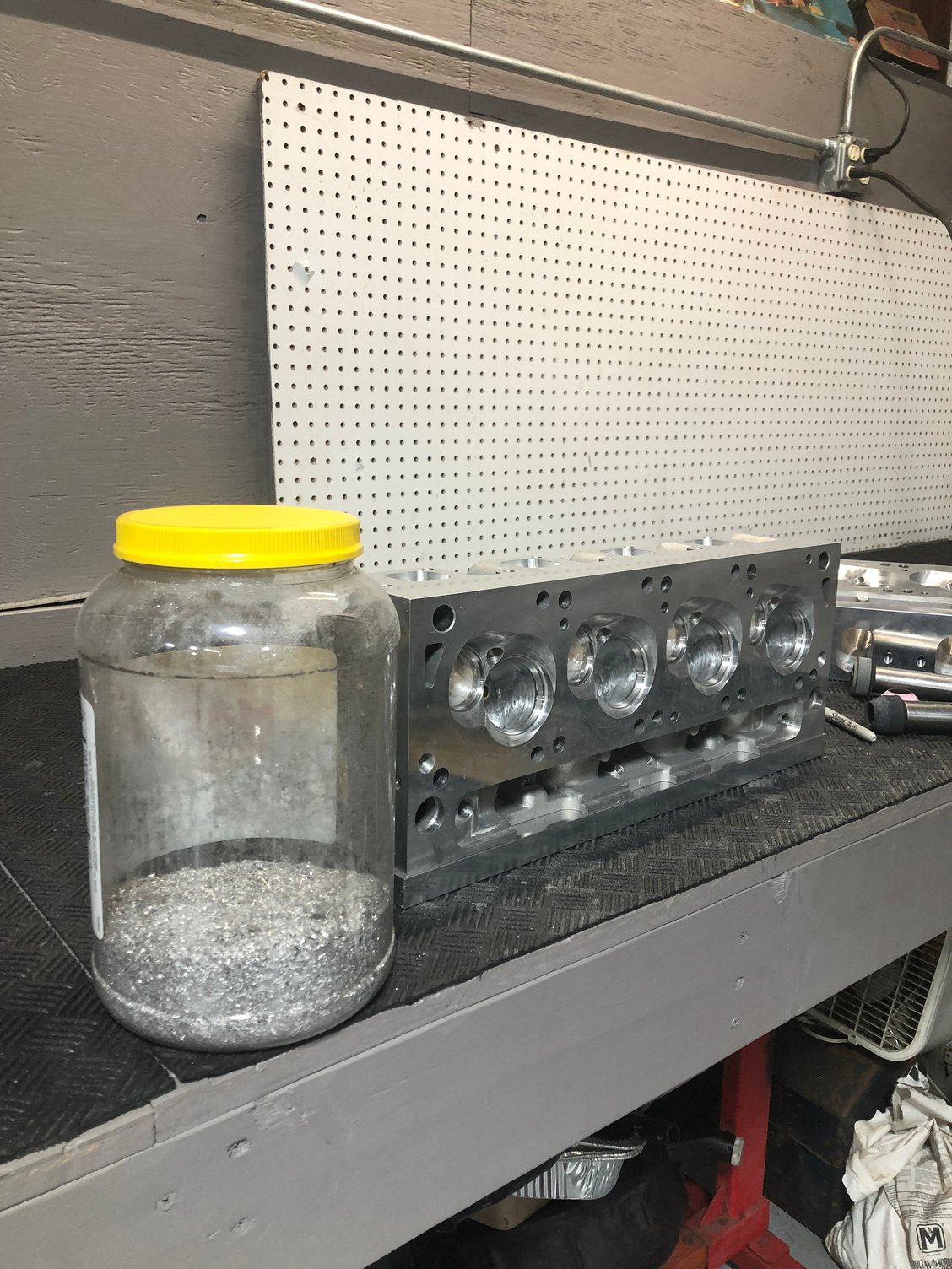

Seems like DeWalt and a couple of others have them. I've also seen a peddle switch that plugs inbetween grinder and wall to vary RPM...but I haven't used one yet.
You can use HF inside outside calipers...comes in a set with a bunch of others for about $10. Then use a good digital caliper to measure them.
Pay close attention to the throat area under the seat. Don't go too big...it will ruin the flow. You need to measure that one closely. Typically intake in the 90% range of the valve to maintain a venturi effect.
Here's the aluminum I recently removed from the heads and intake I ported for my project...LOL
JIM
