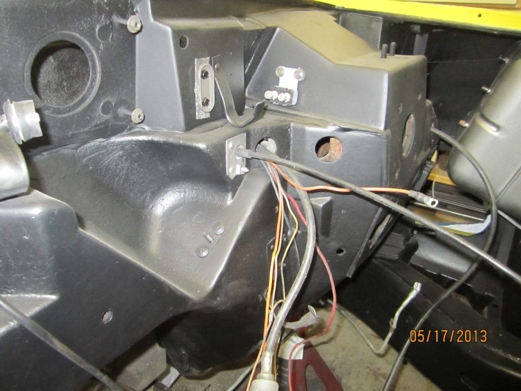

Breaker is out on the firewall just to the right (drivers) side of the wiper motor a bit. Check for power there

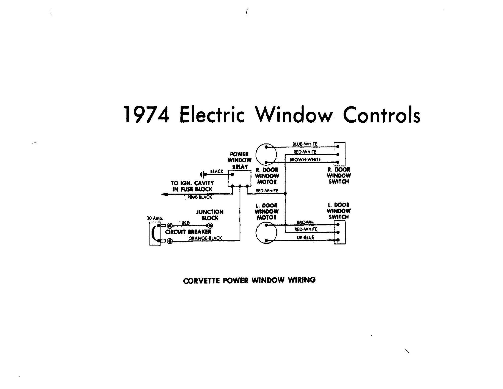

No different than the one posted above but from a 72

there's the relay breaker with no wires connected yet. Bolted to the side of the firewall where it comes out for the brake master cylinder

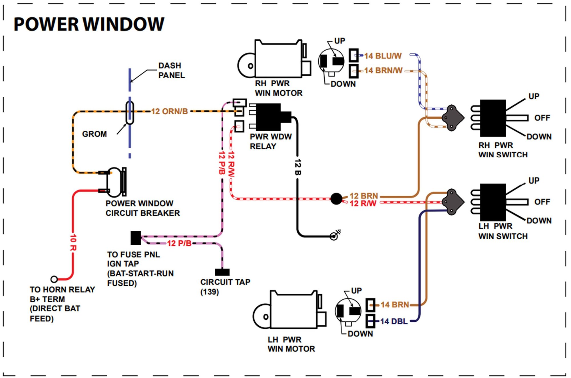

Oh, and make sure the wire that gets plugged into the fuse block (12 P/B above) didn't just get knocked loose by your foot or something. Always go for the easy stuff first
