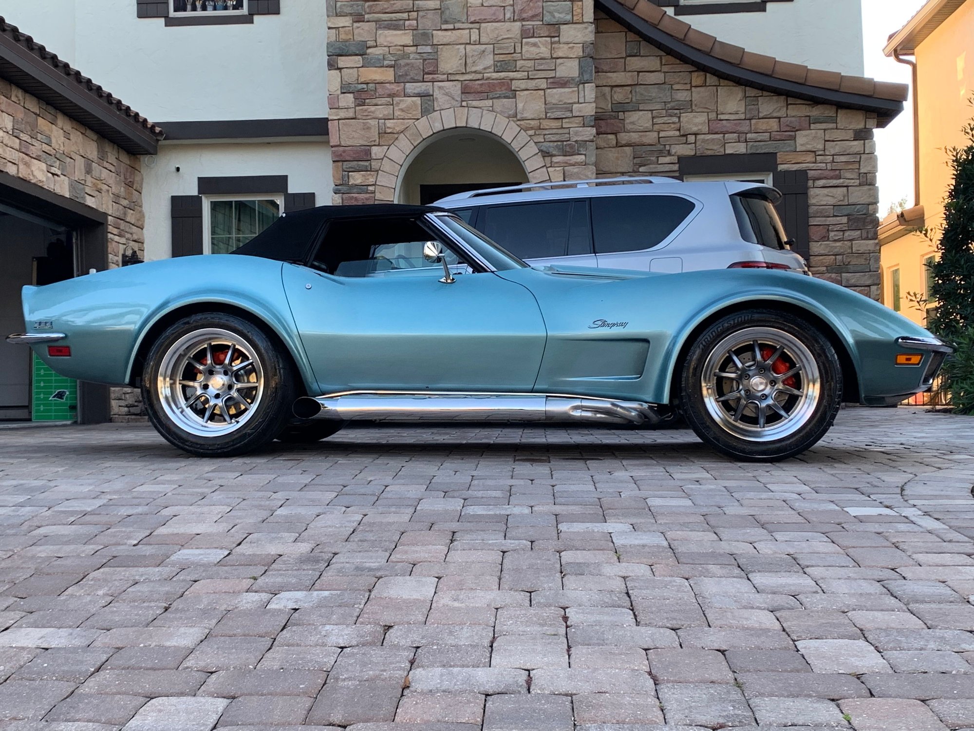

Well life got in the way but I executed my plan with positive results.
so I ordered the 18x9 Torq thrust wheels in chrome but got the off the shelf 5” backspacing. I then ordered a set of .750” Motorsport wheel spacers bring the actual backspace to 4.25.
I gotta say, the fitment looks GREAT! I am thinking of swapping the rear wheels with 18x10 wheels and using the same spacers, which should take the off the shelf 5.75 backspace down to the proven 5” backspace …
ill shoot up some pictures for reference …

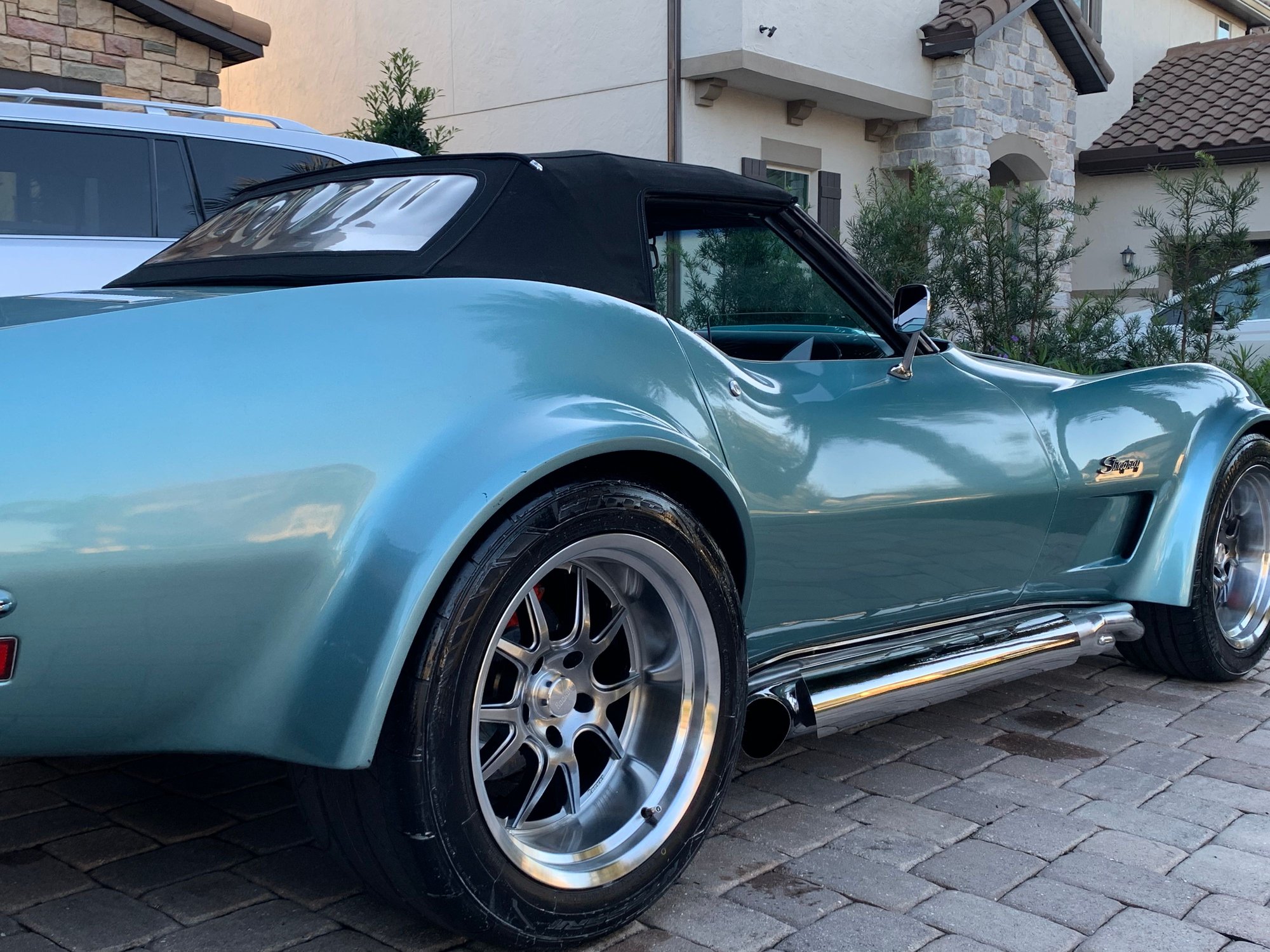

18 x 9 with 4.5" backspace are the same a factory tire placement. adds 1/4" more to the inner and outer edge of the tire.
but ....
I would go 18 x 9.5" with 4.75" BS and use 275 40R18 tires all around. No mods to anything including rear parking brake brackets.

The wheel spacers have 1/2 wheel lugs, someday when I rebuild the rear trailing arm and front hubs, I’ll upgrade the 7/16 lugs with 1/2” … thread engagement is not an issue …
but ....
actually you and I have the same “stance” (hate using that Honda boi term) , but I just have a little bit more room INSIDE my fender …
unfortunately I really wanted for thrust wheels. And I’ve had enough with polished (I always mess them up) soooo I went chrome torq thrust but was stuck with their non custom sizing … I really wanted 18x10 rear, but I was scared, I’ll swap them in the future and can still use the same spacers …
