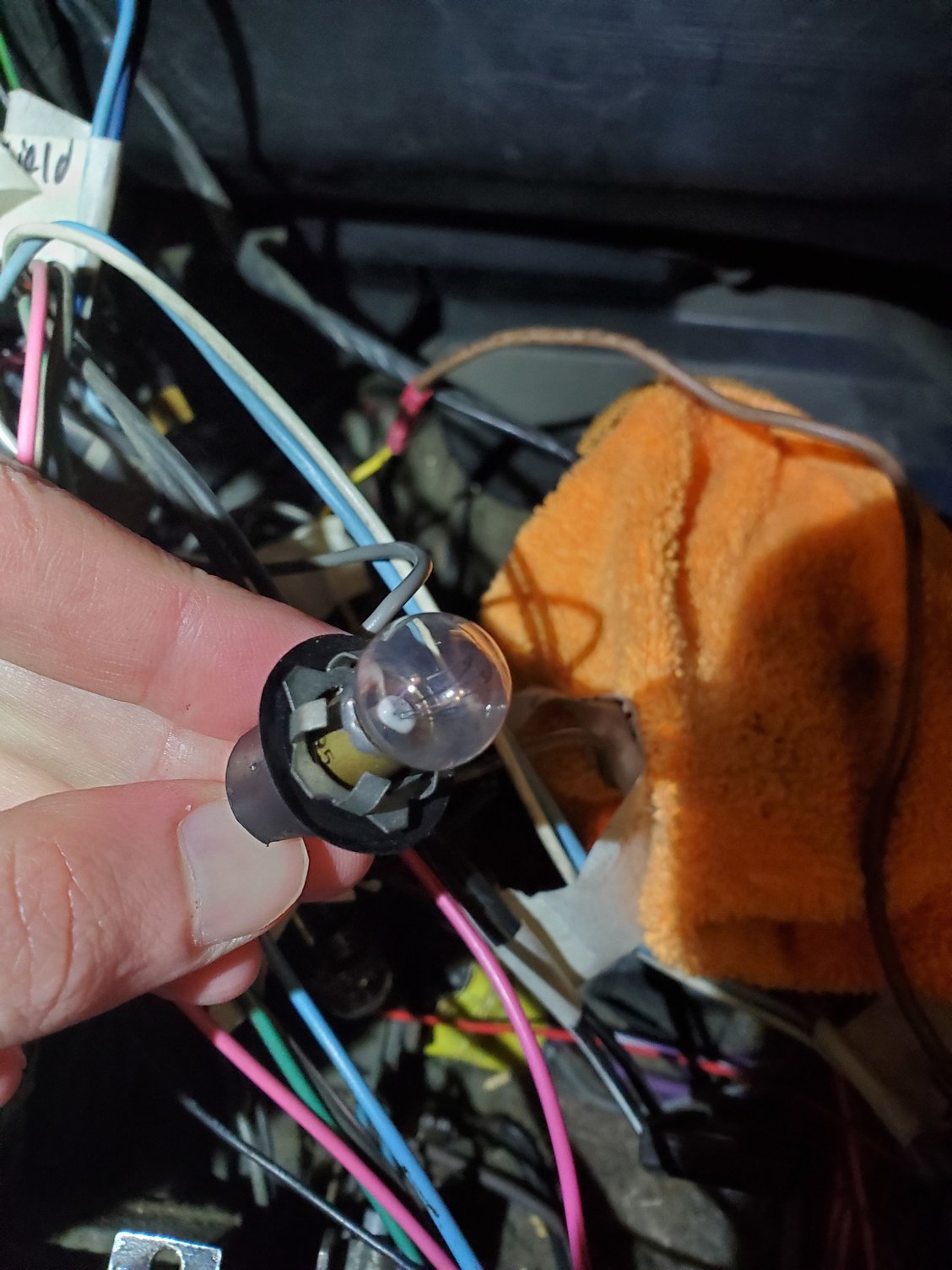

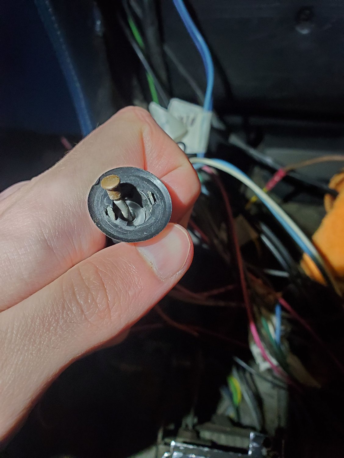

How can I fix this? Found this after taking center cluster apart.
Broken one
This one is good

Looks like the metal part pulled out of the plastic part
I had a couple do that. The metal part is most likely still stuck in the back of your cluster. Carefully pry it out with a small screwdriver. Rejoin the two parts with a couple drops of super glue.
Or you can just buy new socket's and splice them in.

These 5/8" sockets are available in both plastic and metal.
Plastic being correct LINK:https://www.corvettecentral.com/c3-6...d%26q%3d661079
The metal socket at C.C. is part number 661079
