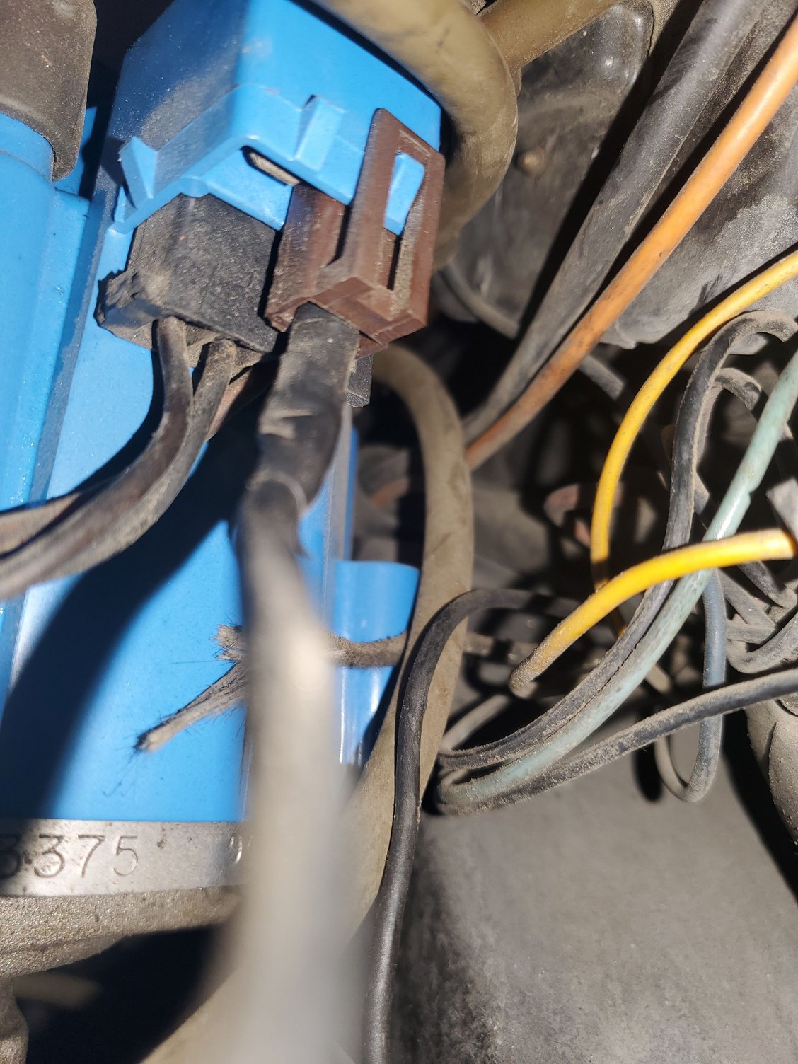

I have a 73 4 speed L48, and tach (and speedo) don't work. I saw online you can remove the tach cable and spin it to see if problem is in distributor or at cable/gauge itself. I'm slowly learning more about my car (thanks to everyone here and all the recommended books).
I found in engine bay my tach cable was disconnected at distributor. I turned it by hand and it was free, so then I hooked it up to drill going CCW, and saw movement in my tach gauge! My issue is, I can't find any connection for the tach cable at the distributor. I looked at my first post on this forum and someone pointed out I have an HEI distributor.
So my question is: where do I hook up the tach cable (if anywhere)? I saw some HEI distributors still support tach drive but I can't find the location on mine. Do I have to remove the distributor to access the hookup location?
Or, if it isn't driven by tach cable, how do I hook up wires/connector to the tach? I can't seem to find any matching tach wires that go to my tach. I'm guessing it should be connected to the yellow wire in my pictures below.
I dont know anything about distributors, figured I would ask here while I research it on the side. Thanks

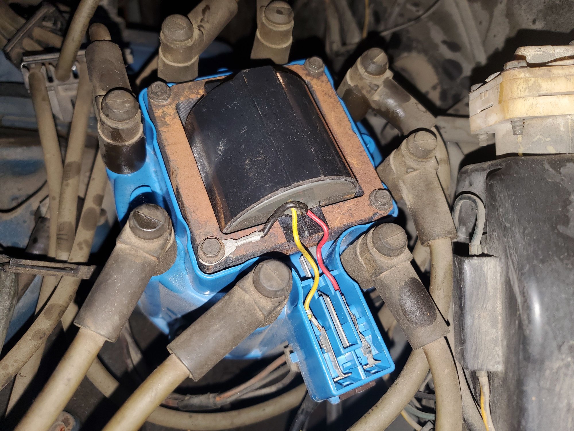

View of distributor
Distributor with top plastic cover removed. Theres a black wire connected to the red wire, but nothing connected to the yellow one. You can see this in omage below
Yellow terminal (left side) empty, no connection

They make HEI distributors with a gear driven tach output. It looks like your car didn't get that, nor did it get an electric tach conversion. Don't hold me to this, but I think the change from gear-driven (mechanical) tach to electronic occured in 1975.
Either is a solution for your current situation, but it sounds like you will have to choose one or the other.

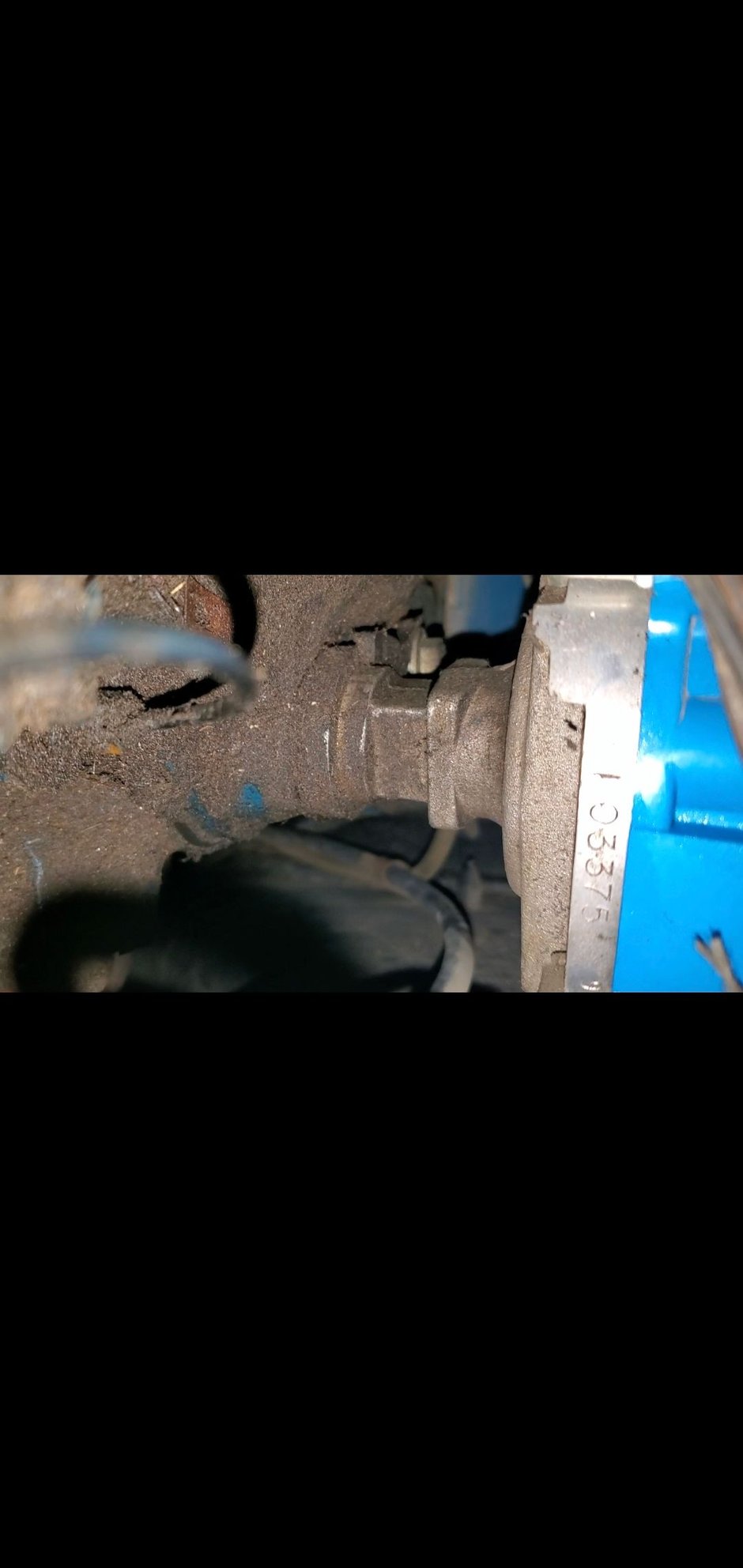

I tried looking under the plastic cover for tach drive location, but couldn't find one. I'm now fairly certain this distributor does not have a tach cable input anywhere, see below pic
Picture of current distributor on car. No tach drive visible. Was able to identify it as delco remy 1103375.
Any recommendations on which path to choose? I am leaning more towards electric conversion of tach since not sure how much more life the tach cable has... but open to either option. Will look at prices and options from the vendors tomorrow

If it were my car, I'd keep the HEI and convert the tach. But I haven't been faced with the challenge that you have. Getting the dash cluster out of a 78-82 is a lot easier than what you may have to do.
And before you decide, does that distributor have a vacuum advance? Is your timing (and perceived performance) what you expect?

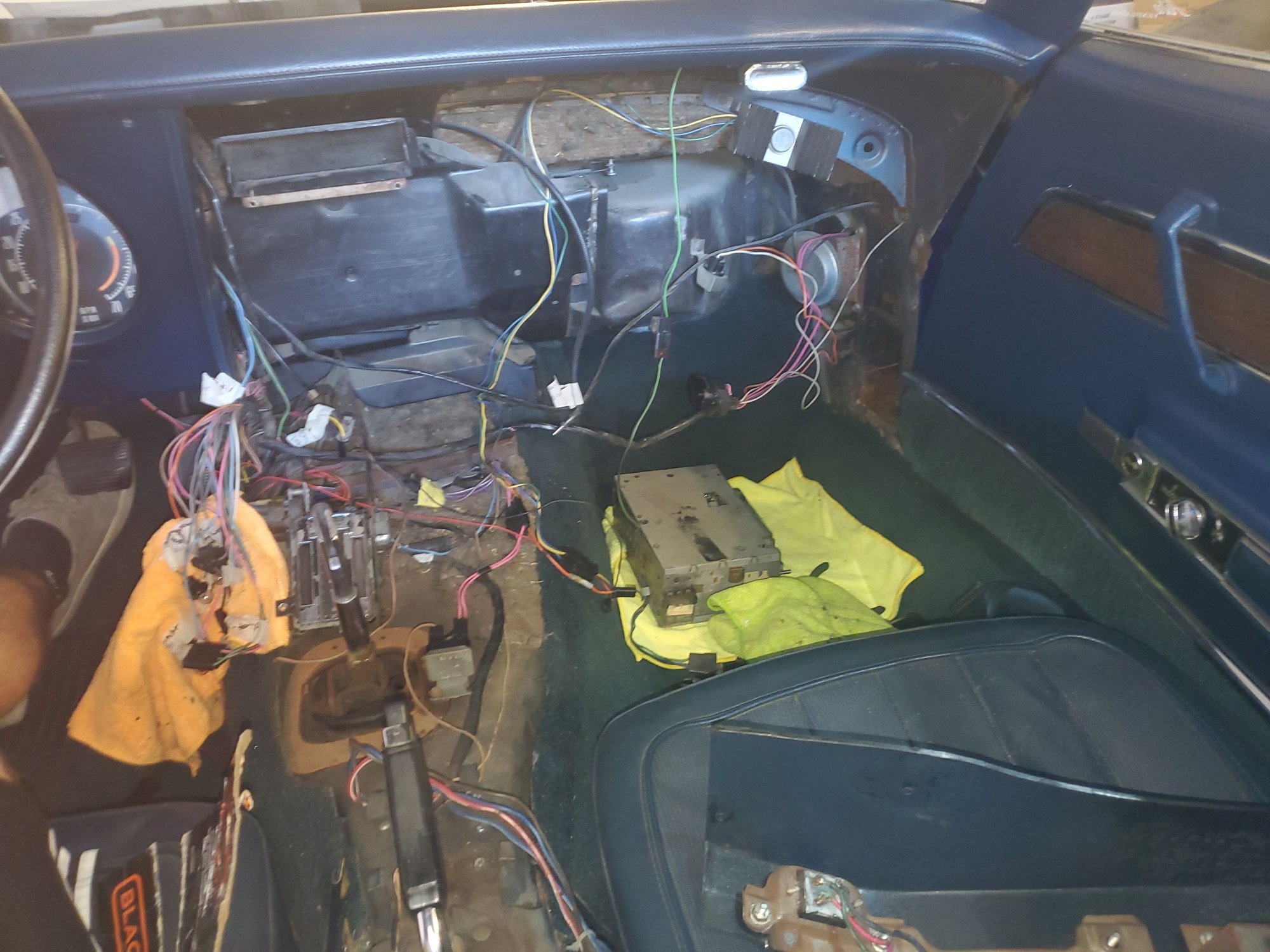

Thanks Jebby and others for your advice. I do need to remove driver dash anyways to diagnose speedo issues too, and ensure I have good grounds. So we can assume I will tearing all that apart anyway. I also want to inspection bubba wiring under driver area with the aftermarket alarm..
Currently in my car, I already have the center cluster out and passenger dash out
Current state of affairs
