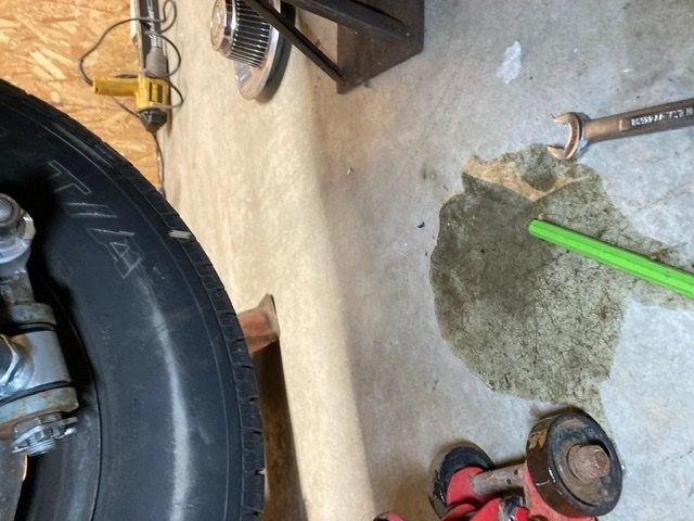

My car is stored in the garage over the winter and tonight I noticed some fluid coming from underneath the rear drivers side tire area. Upon closer inspection it looks like its might be coming from the brake. Full disclosure the car was jacked up slightly so the tires would not have flat spots (I did this last year with no issues) It's been this way since November and hasn't moved. Could the cold cause a small leak like this? Car details: 69 Convert, 4 speed, 350/350, manual brakes, manual steering. Park brake was fixed last summer along with some other minor items. I won't inspect it until spring time but just wanted to know what to check for once I get the wheel off. Thanks.

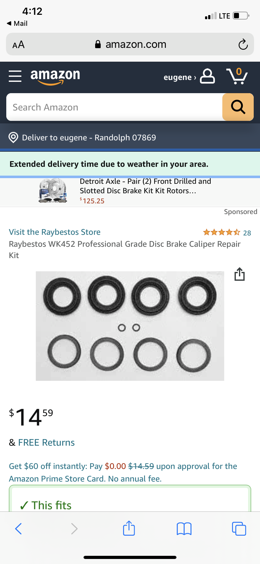

Here’s the kit you want
I have been rebuilding these calipers for 30 years this is the softest rubber you can get USA

Old Feb 24, 2022 | 09:16 PM
michjim72's Avatar
michjim72
Joined: Dec 2019
Posts: 27
Likes: 19
From: Shelby Township, Michigan
Thanks for the advice. It was coming from inside the wheel. More than likely the caliper. No more leaking since I took it off the jacks. Wait til the weather brakes before looking at it. Another 2-4" of snow expected here in Michigan.
