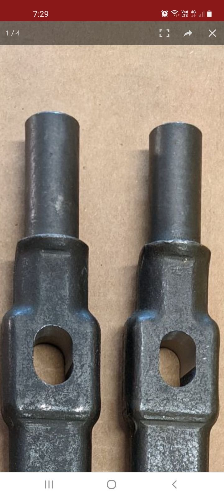

Off set and slotted upper A arm shafts is the answer.
