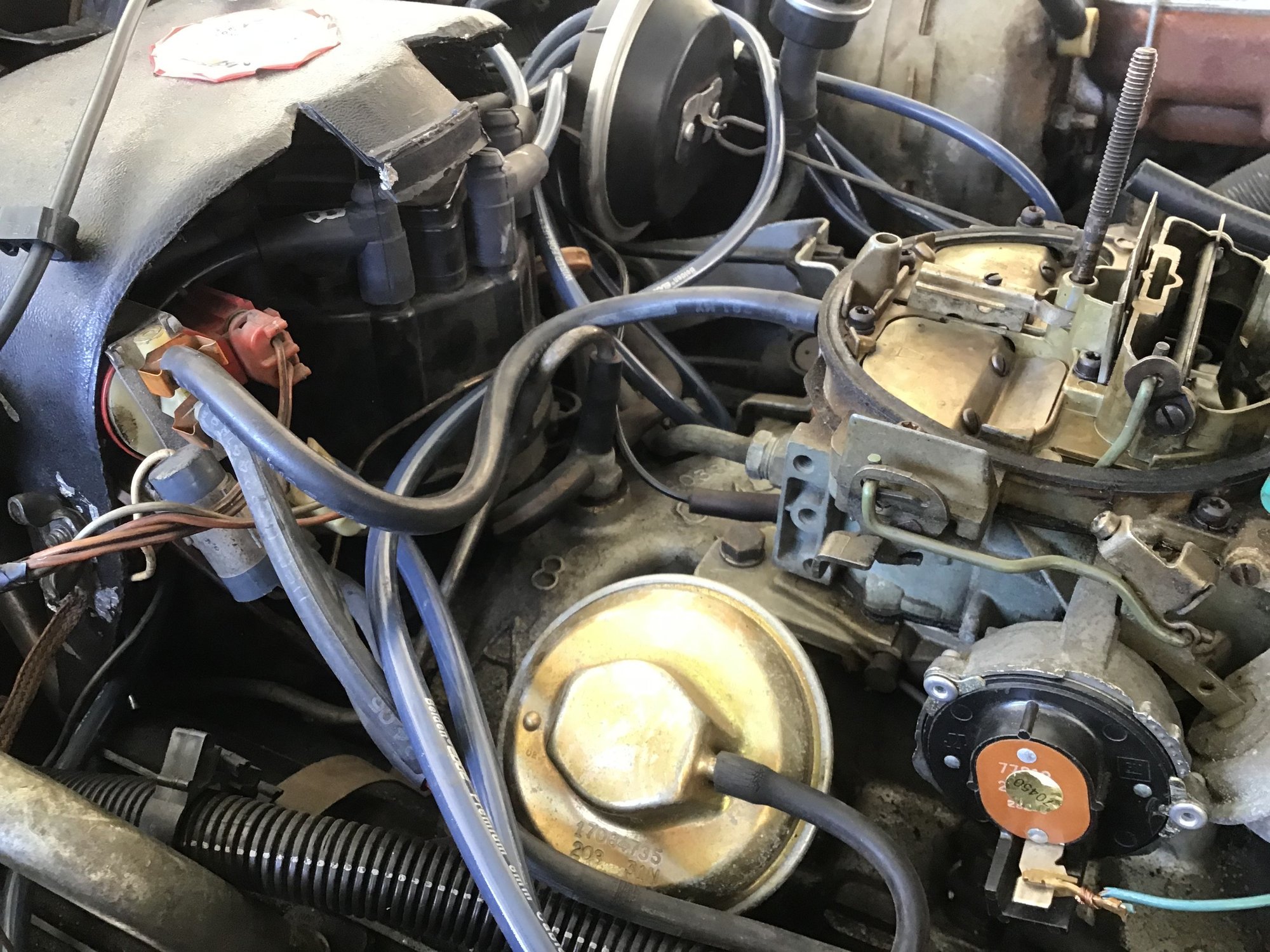

I know there are still quite a few still running the computer carburetor from 1981,and hadn’t had this car a month yet,and BOY have I learned a lot,so want to know how far I can go performance wise without interfering with any type warning or check engine lights, My plans keeping the CCC and replacing distributor,adding long tube headers and different heads.

If your replacing the distributor, your on your way. Then replace the computer controlled carb. Etc.
If you want to keep the computer controlled carb. then keep the entire system and live with the lack of power.
You can not have your cake and eat it too.

If you are replacing the distributor with a 4-wire HEI, you are halfway there already. You should be able to remove the bulb for the CEL without taking your dash apart. You may need to remove the passenger seat to get the angle you need, but you can then reach your hand behind the center console and untwist the bulb socket. Here's a thread with a photo.
https://www.corvetteforum.com/forums...d-sockets.html
But seriously, if you are doing what you propose, follow @4-vettes' suggestion. Revert back to an earlier-spec Q-Jet carb, preferably one with an electronic choke. There are several recent threads where folks have gone through this.

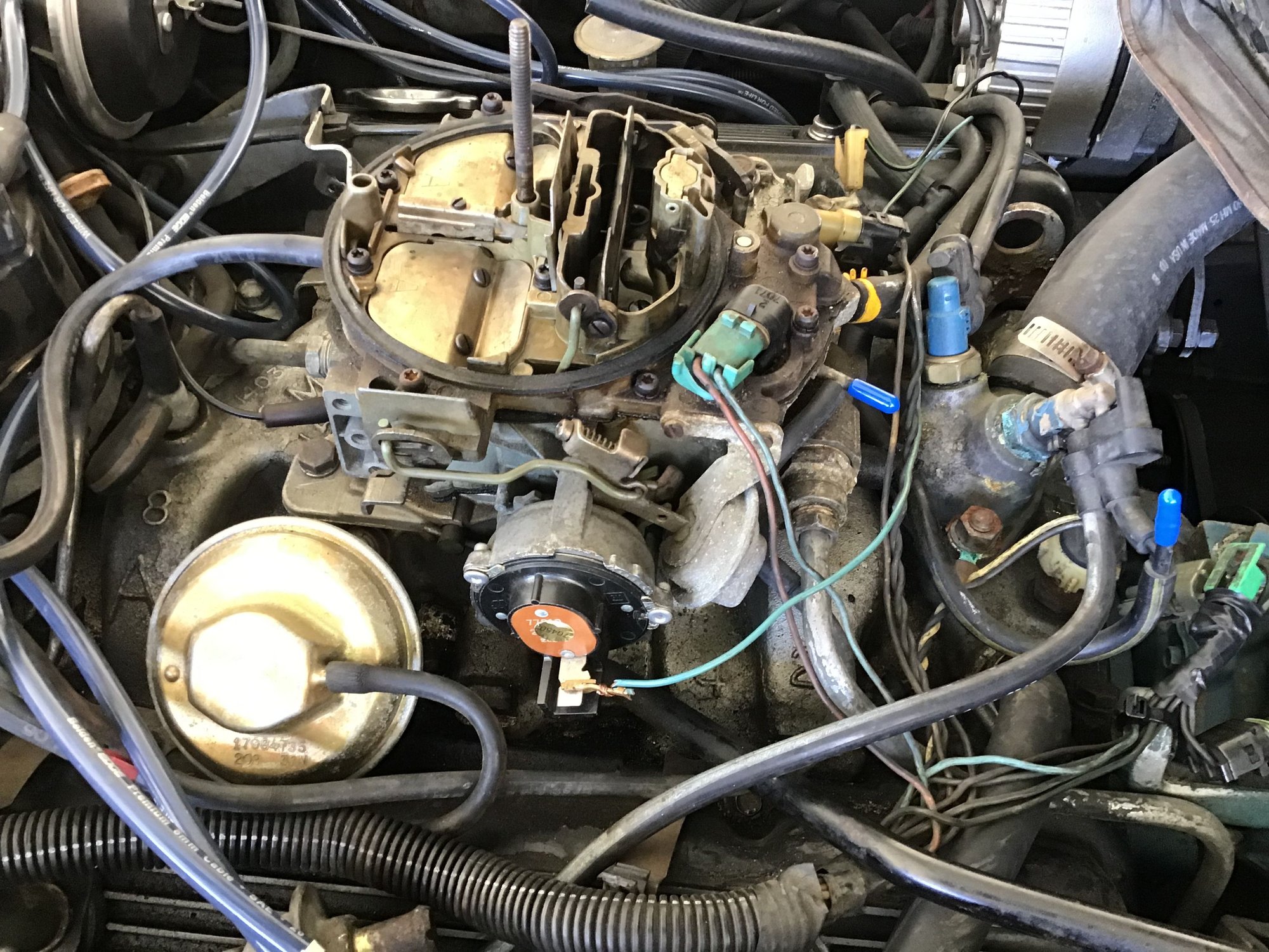

when you turn the key to run, not started,
does the yellow check engine light come on?
under ash tray the ccc connector plug is there.
5 spade connector
short the 2 with a slot in them
makes ccc light blink
put a dwell meter 6cyl scale on green plug
hanging loose between a/c comp and carb
and ground to see what carb is doing at idle.

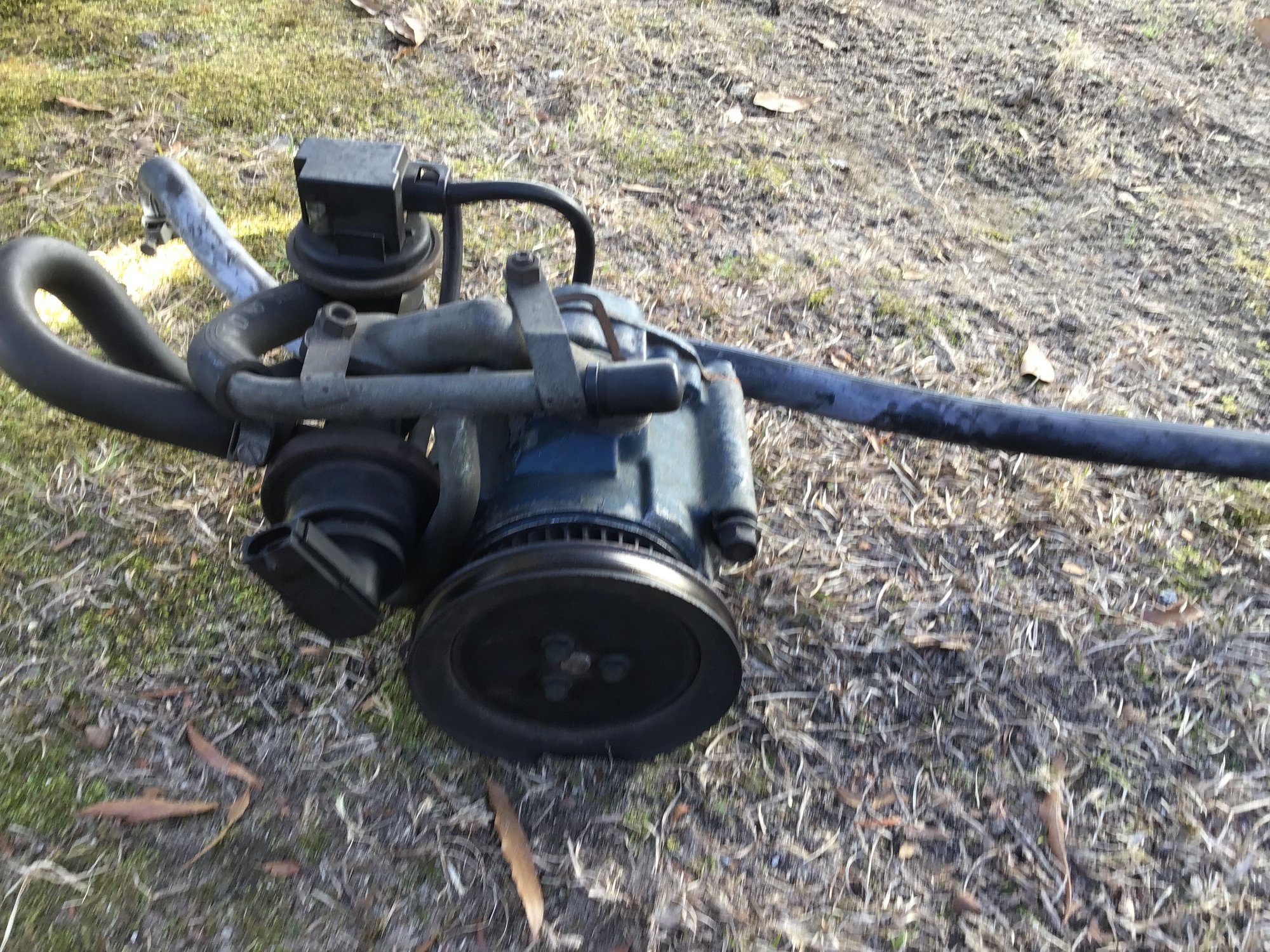

Pulled this off yesterday,and you could tell immediately how the engine could finally breathe,lol...so,will let the horses run now.lol talked to Summitt and They have been a big help.

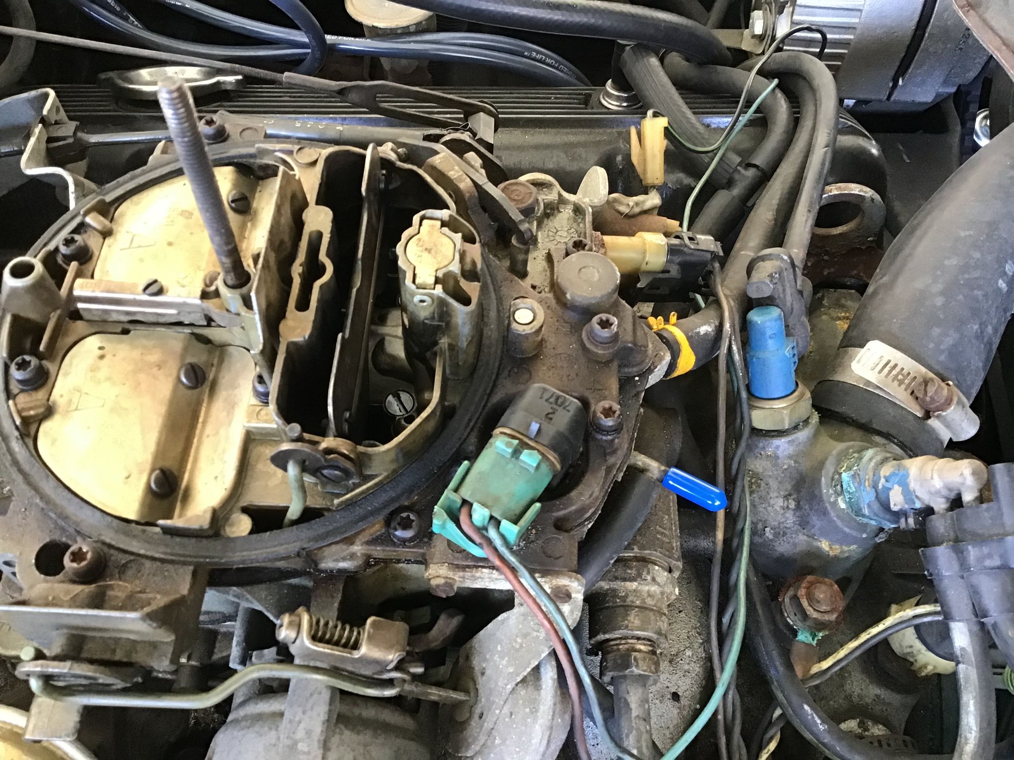

If you put an Edelbrock AVS on the stock intake you will regret it. The required adapter has such a mismatch on the primary side that it will never run correctly.
If you want to use that carb, then replace the stock intake with a 2101 Performer.
Jebby

It will fit...yes I am sure.
It fits under the hood od a 68-72 and they have even less clearance than an 80-82.
