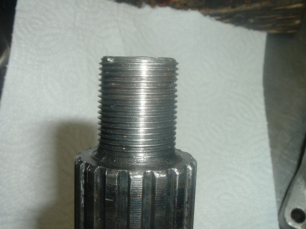

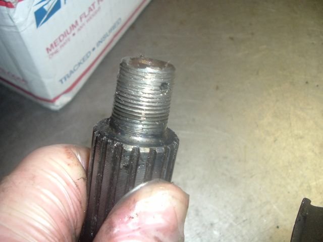

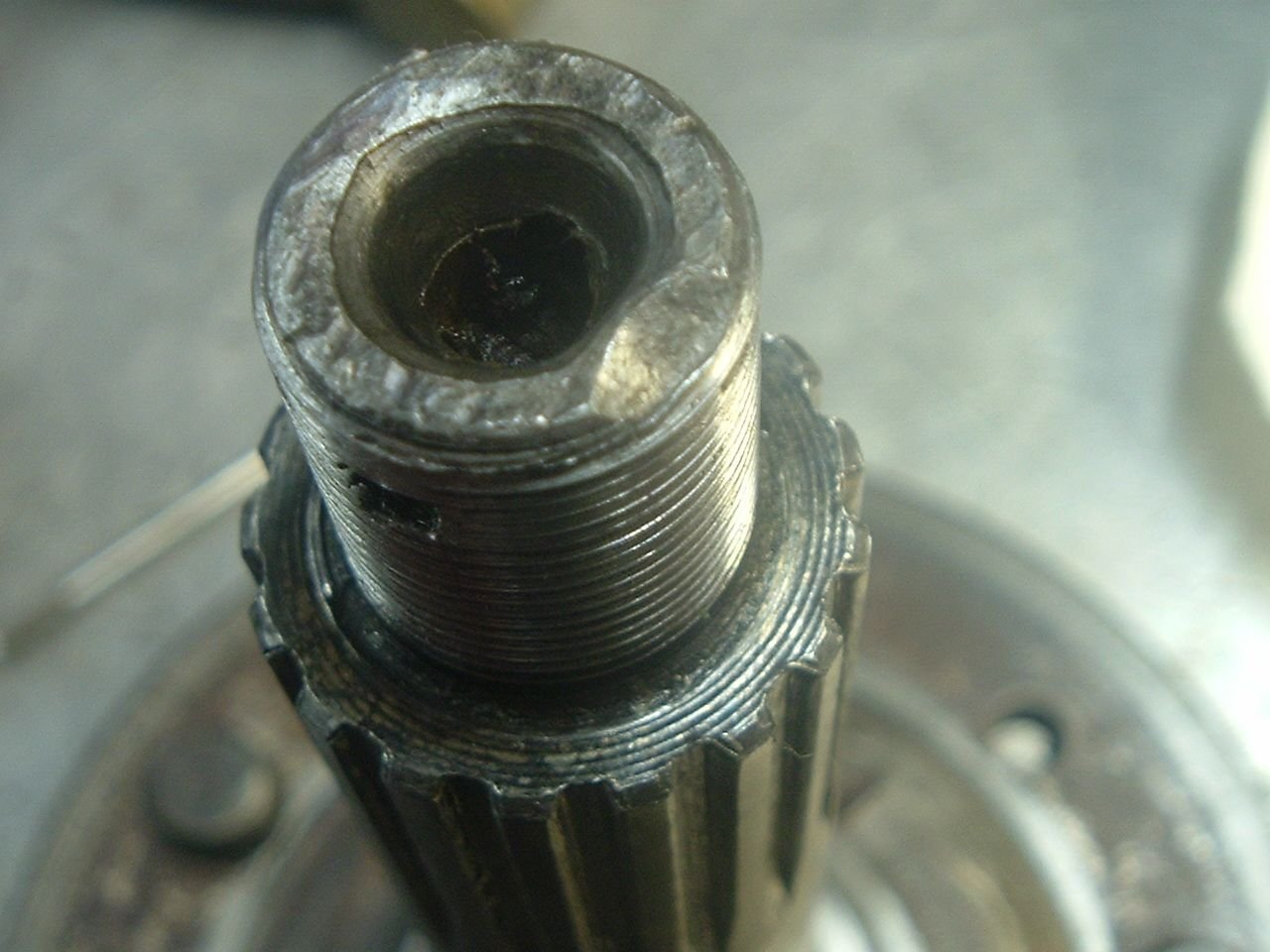

The stripped threads on the axle are also common on mid C3 axles because there is a common stake mark on some original axles. The mark is the same on all the axles I have seen, and that is a few of them. If the nut is backed off without addressing the stake you will see the result. Sometimes it can't be avoided or has been previously worked on. This is the type of thing those social media guys have no clue or experience with and could be a $200 mistake. The threads can be dressed several ways.

Is the stake mark on the nut, staking it into the axle threads, or on the axle thread, staking it into the nut?
Looking at the picture above I'd guess the stake is on the nut, and it messes up the threads as the nut is removed.
And how do you remove the stake? Small file? Or can you un-stake it with a hammer and punch?

The staking of the threads I have seen on the mid 70's axles is shown in the picture. The first one I saw I just figured it was the handy work of some previous guy but more and more I see the same indent in the same place. A small file may work, I have several chasing tools and the die for those axles. A chamfer can be cut into the end as well but most times I don't have to do that unless it's really bad and it's the last attempt to save an original axle. Now with previous work all bets are off as many are mushroomed over not staked because the correct hammer tool wasn't used. These pictures show the threads after I restored them and how they should look.
threads restored
Threads staked
