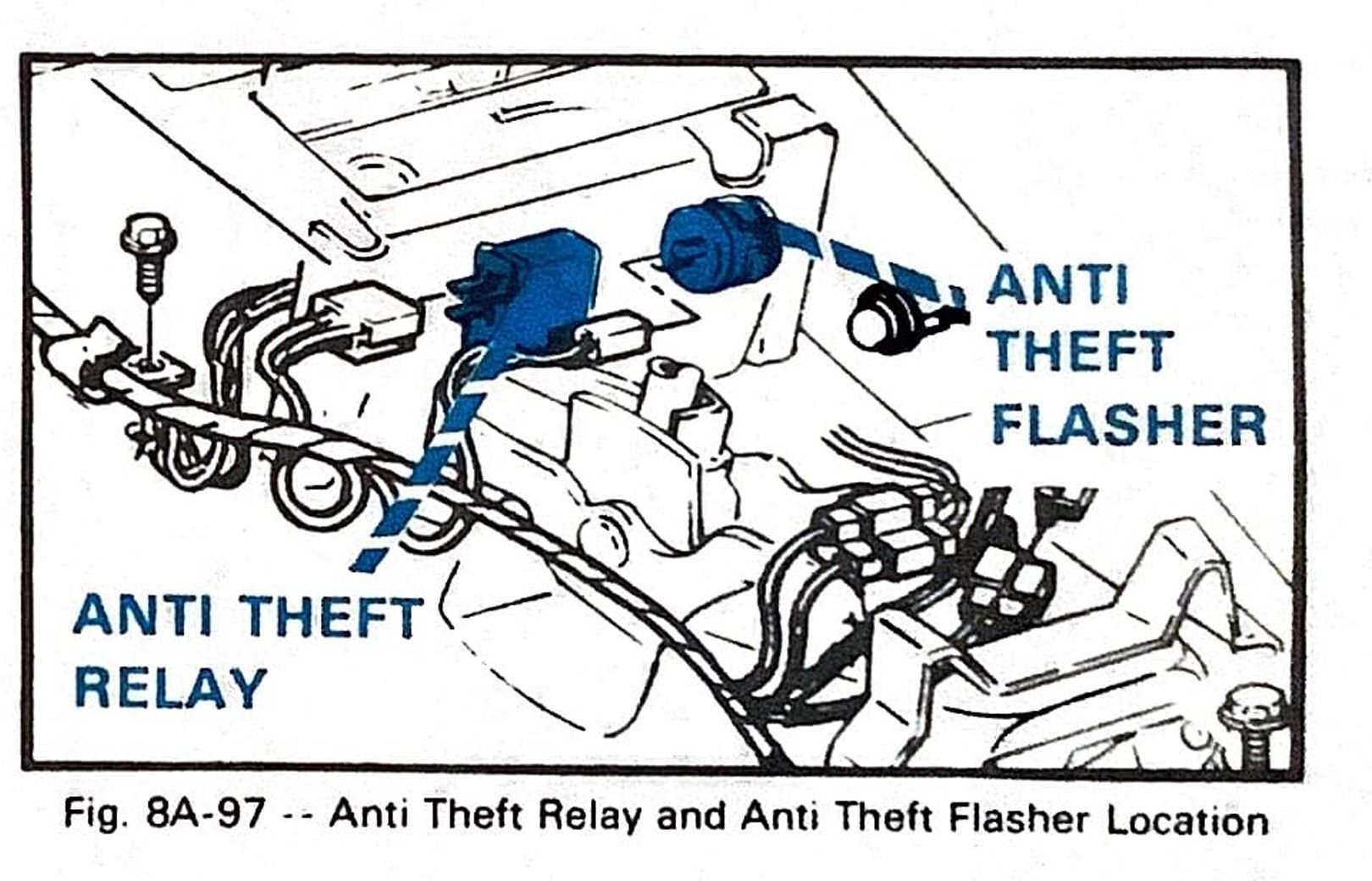

Maybe one of these

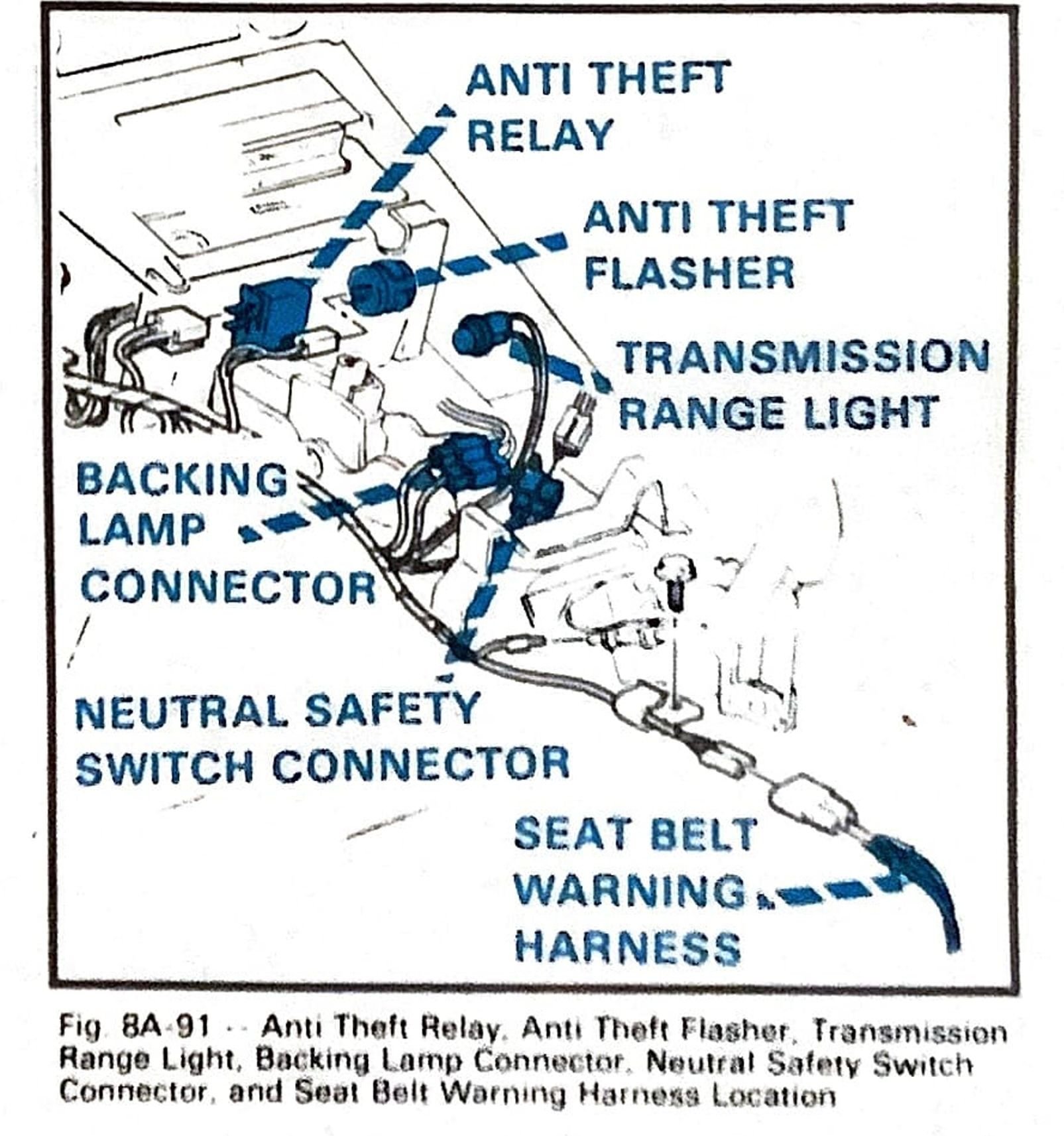

GM built 1 Main Dash Harness for the 79 Corvette to except ALL provisions so there may be connectors & lamp(s) not used.
Looking at the 79 wiring diagram the LT.GRN & DK.BLU "L" shape 2 wire connector would be for the backup lamps for a automatic.
The PPL & YEL "T" shape 2 wire connector would be for the Neutral Safety Switch for a automatic.
