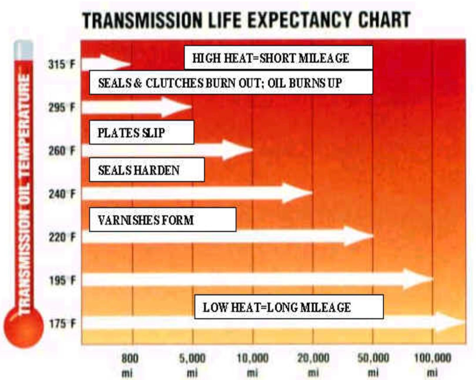

Assuming a quality rebuild, the only real threat with the driving conditions you describe is heat. It is the number one cause of automatic transmission failure.

As Factoid charted: an add-on trans cooler to keep fluid temps down will be the biggest life extender along with clean fluids.
