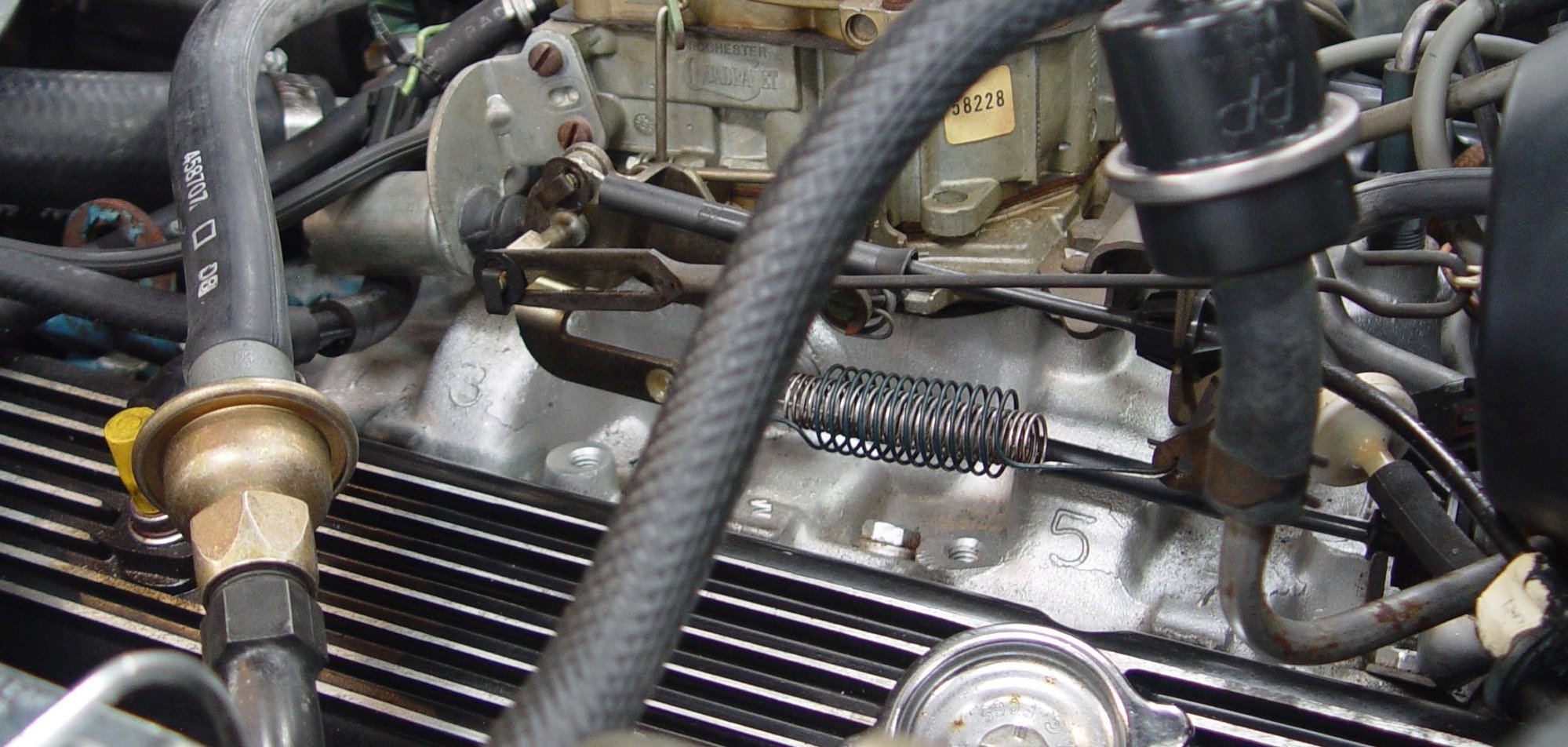

But let's also consider that engines were assembled at Flint engine assembly plant and at the rate and requirement for engines, all would have been processed the same way. As I recall, the engine color (GM Corporate blue) was painted with the manifold in place and after the manifold had been painted. Thus we would typically see blue overspray on manifolds as well as the thermostat housing.

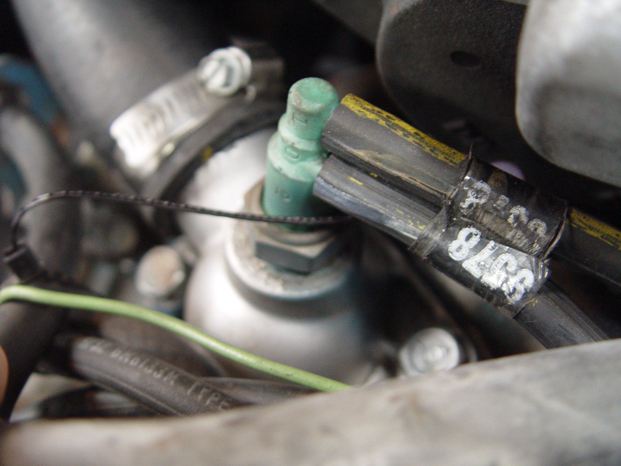

After the last post, I recalled a 78 B2Z L82 we looked at in Lakeland this past February...low-mileage and a nice original car. Here's a couple of images, the first shows the thermostat housing and engine paint overspray. The second shows the passenger side engine lift bracket but note the color and brightness of the manifold...quite silver.
