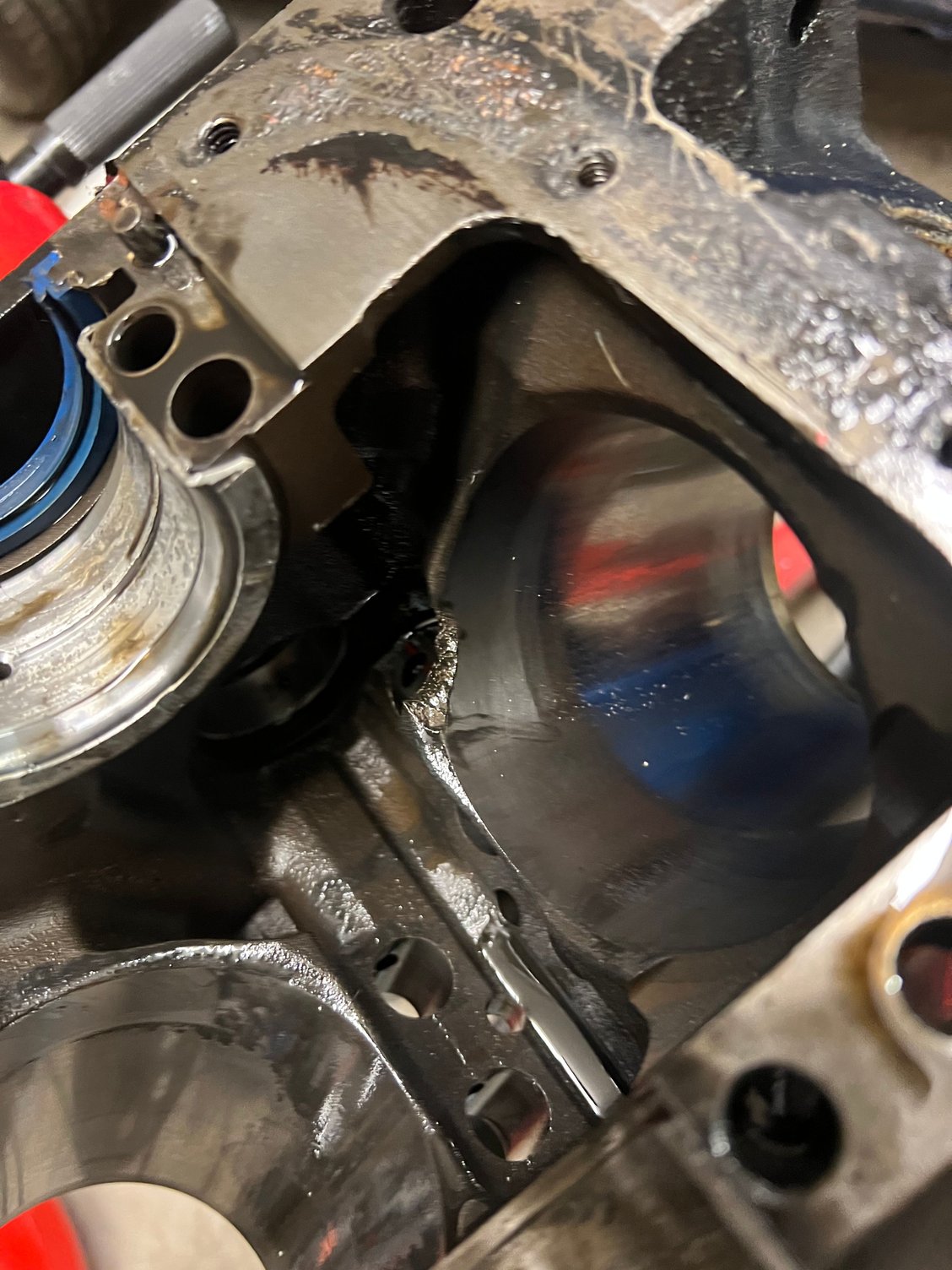

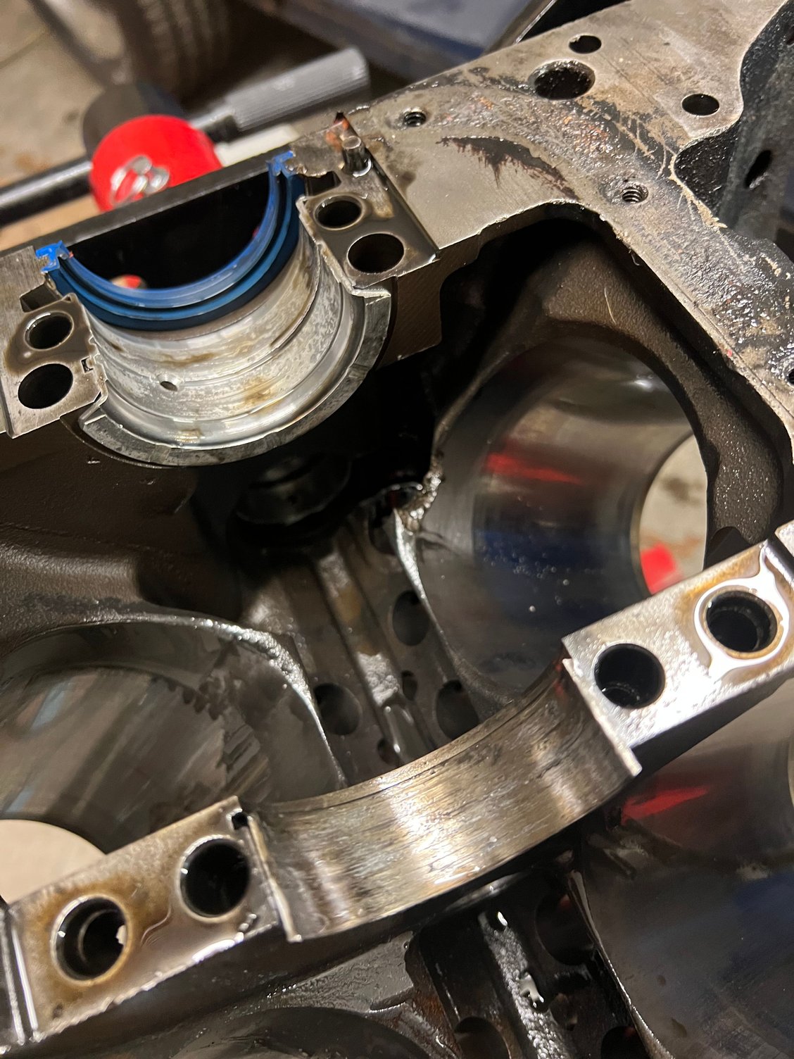

Hey guys me again. Same block as before except completely tore down now. And uh. Found this.
Saveable or new block time?

so, you snapped #8 connecting rod. anything can be repaired. we don't know anything about the block. numbers matching to the car and special? it is a 4 bolt. but a lot are. if the numbers natch, put it in the corner and decide later. if not get 10 cents a pound for it. now, go find a 96-02 chevy express van that popped the intake gasket and take that 4 bolt roller vortec block and start over. you may be able to re-ring it and go. my 01 gmc savana had a gallon of water in the pan when i bought it. put heads on it and have done 2 round trips from jersey to florida so far. you give GM engineers 40 years to improve an engine and they are gonna improve that engine... where is home for you? i am good at finding stuff.

clean off the oil and take it to a machine shop and have it magnafluxed. If its severely cracked junk it or have it sleeved. THat area is below the rings so its not critical area. The machinist will give you an educated answer to different possibilities, not a bunch of keyboard hacks saying this or that. The only legitimate reason to save a severely cracked block is if its a rare big block or its a numbers matching block

i believe that is a major light leak in the bottom of the cylinder.

the rings are well above that chip unless there is a crack that runs up the cylinder bore

i saved image and blew it up. pretty sure it is a hole into water jacket.
then that is very bad....and an anchor, unless its a numbers matching motor and the OP wants to spend some money on a costly repair

I went and bought a new block. Same cast numbers and also a 4 bolt and a plus of it is it’s not been bored before. Now I Just gotta bring new one to machine shop and Rebore

Also no rods were broke. All the bearings were ate up though.

then what ate that lower corner of the #8 cylinder? and 383-388. balance is usually external. so a flywheel and balancer will need to be matched to the rotating assy. unless it will be neutral balanced. 6 inch rods should be looked into, but a bit harder with longer stroke. but also more needed with longer stroke. and now your inadequate stock heads just became more inadequate.
I believe it was the lifter it ate a few months ago. I planned on buying one of the balanced rotating kits from summit. And heads had already been decided upon buying some new AFR ones those got to the house the other day.
