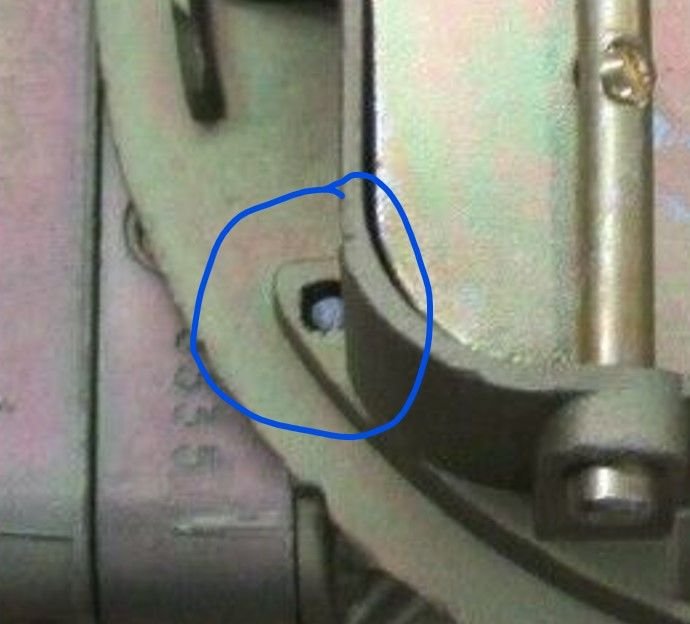

Ok if you have done all the other common checks, and are still have mixture screw problems, so did I. One side of mine responded drastically different than the other to the mixture screw. It made no sense.
Until...
Refer to the pic below:
This is my 4803 Holley for my 454 LS6. It is an almost identical twin carb to the LT-1 carb, minus some jetting changes for the extra cubes. However this one is not a factory installed carb. This one was a purchased over the chevy counter version mfg'd in the mid 70s. You want to pay very close attention to the "dimple" area outside the choke horn circled in blue.
Here is the same dimple looking straight down from above the carb. That dimple is now circled in red. Notice how my carb has a tapered metallic cone shaped bottom in that dimple. 99% of Holleys look like this. A factory OEM LT-1 carb is not like that. My 1970 LT-1 carb had what looked like gold colored body putty in that indentation area. And because of several carb cleanings it had started to come loose and crack. I removed it with a very small pic tool and found a SCREW underneath!?!?!? WTH!?!?! That factory carb had adjustable air bleeds installed to help the solid lifter / Holley motors get thru 1970s emissions. I did find a reference to it in a Holley book once. The screw looked much like an idle mixture screw but was smaller, brass, and had a ROUND tip, since it was for air. If you look directly across the choke horn in the pic above you will see the corresponding air bleed (blue). IIRC this is the low speed air bleed. You can see the brass restriction placed in my 454 "counter" carb above, because that one does not have an adjustable air bleed, it has a fixed orifice brass air bleed, although pretty large. A true factory installed LT-1 carb will have NO brass restriction in that air bleed, because the restriction is done by the screw. The above air bleed is a large fixed orifice because it is for a 454. Over the counter 350 carbs have smaller orifice air bleeds. But my factory LT-1 carb had none at all, just a big gaping hole! And One of those screws had become loose, and had changed it's adjustment, and was different from the other side. That is what cause my idle / low speed problems. I basically had two different air bleed settings right side & left side!
I sent it back to Holley in the early 1980s and they rebuilt the carb in their hot rod shop. They even looked up the factory blue-prints and found the part number for that screw and replaced both of mine. (It was a brass screw and I had ruined the slot on one.) They tuned the air bleeds on their flowbench to factory specs. Even the Holley tech did not understand what I was talking about until he saw the carb, and found the original blue-prints. Even in the 1980s no one at their shop remembered ever seeing one of those carbs with those screws before. It is easy to see how they would get overlooked in even a good rebuild / refurnish. They may be very rare, and only found in '70-72 OEM solid lifter Chevy Holleys. So 70-72 LS6 & LT-1 only. I am pretty sure the 69s did not have these screws.
So check your carb to see if you have the missing brass restriction in the air bleed, and if your "dimple" looks different than mine above. Then you will know if you have the hidden air screws or not, just with that visual inspection. If all other tuning tips fail, talk to Holley! If Holley can't help you anymore, (it has been 40 years) I would think you would have to adjust them on a dyno by tuning the AFR with an oxygen sensor. After you find someone that understands how to adjust air bleeds!
They made more Chevelles with that carb (4500 LS6s) or Camaros (4500 LT-1s) so you may find more knowledge over there, than here.
Good luck!
I just looked online quick and found an 081 dated 4801 Holley. The pic just so happens to show the missing brass restrictor in the low speed air bleed inside the choke horn! So this must really be an OEM factory installed carb.
This pic unfortunately does not show a close-up of the "dimple" area.
Here is another 4801 I found online that shows the drilled "dimple" location that contains the hidden screw. This looks original to me also. But it also looks like someone "picked" at it. I am not sure if that is the screw or putty we are seeing there.
Since the last carb pic'd is priced at $1495, and looks beautiful, you would think it would work perfect! But I doubt it. Those screws are a PITA. I still have tuning nightmares over those things.
