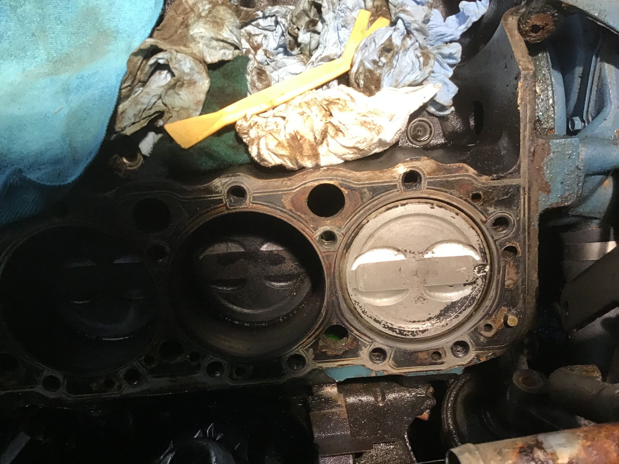

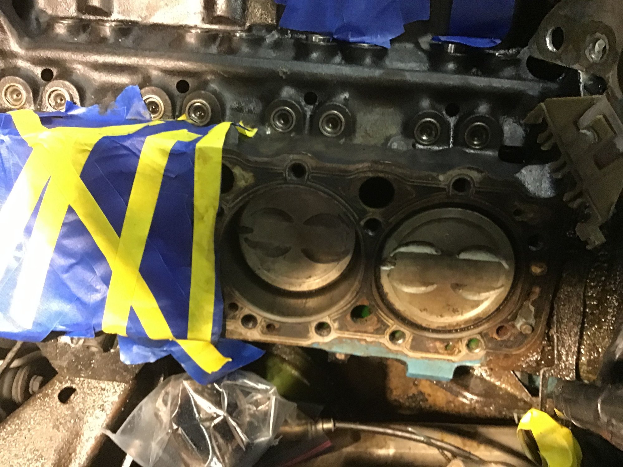

I will post pictures tomorrow,forgot my tablet,I’m doing the work at a friends house,but pulled carburetor,intake and heads off,and to my surprise it looked nice,although do have a little buildup on top of the pistons,so want to plug,or tape openings and get the piston all the way to top and clean them,so need some tips,and using a drill,or a wire wheel.and I just figured when I pulled the heads off,they would just be flat top piston,but they weren’t.post pictures tomorrow,thanks for any and all suggestions.

Fine particles will get into piston ring-grooves....maybe you could apply a layer of grease between piston and cylinder wall to prevent contamination.
Wire wheels lose a few wires when in use...the wires can end up anywhere.

Thanks,and I just bought a new tube of grease,but I do plan on being very careful.but that’s a great idea.

Use the same 3M bristle Roloc you should be using to clean the deck surface to clean the piston head......

Clean it and reassemble. After you get it running good, dribble water through the carb as folks have been doing for years. That'll get all of it off that matters, the thin film of black on most pistons won't make a bit of difference.
Any crap that gets between the block and top ring land will ruin your cylinder finish. Seen it many times.

You may do more harm than good. But if carbon disgruntles you put some painters tape over the head-bolt holes. Which ever piston is at TDC clean that / those first.
Jog the IGN key and a clean couple more piston tops.
Using a pots & pans nylon scrubber or similar pad, just barely rub off the piston grime with one hand and shop vacuum the dirt out with the other hand.
That carbon will return in a matter of days. So don't over do this.

I used a spray can of Permatex gasket remover to dissolve the carbon. Let it sit for a minute and wipe off. Repeat.

If I felt it was necessary to clean the tops I'd go with the grease in the crevice idea. At least you can keep the fine particles from getting into the ring groove.
I'd use something like carb cleaner or the stuff resdoggie recommended to soften it up, then scrape it with a plastic scraper. What ever is left I'd put more cleaner on a rag and wipe the top of the piston until it's clean.
Then roll the crank with a wrench, not the starter, (just me starter is harder to control), and wipe the grease out with a rag dampened with the cleaner.
Using any kind of wire wheel or abrasive type cleaner you don't know where that abrasive will end up.

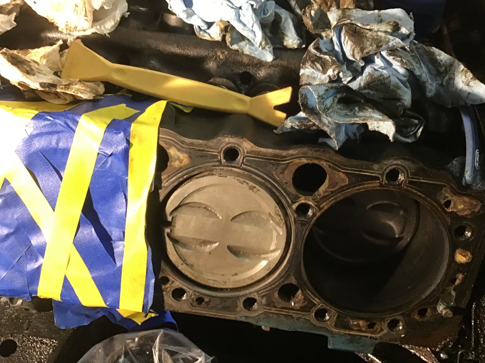

Going to start on piston tops today.
Old Mar 17, 2022 | 08:12 PM
Golferdad's Avatar
Golferdad
Joined: Feb 2022
Posts: 988
Likes: 183
From: South Carolina

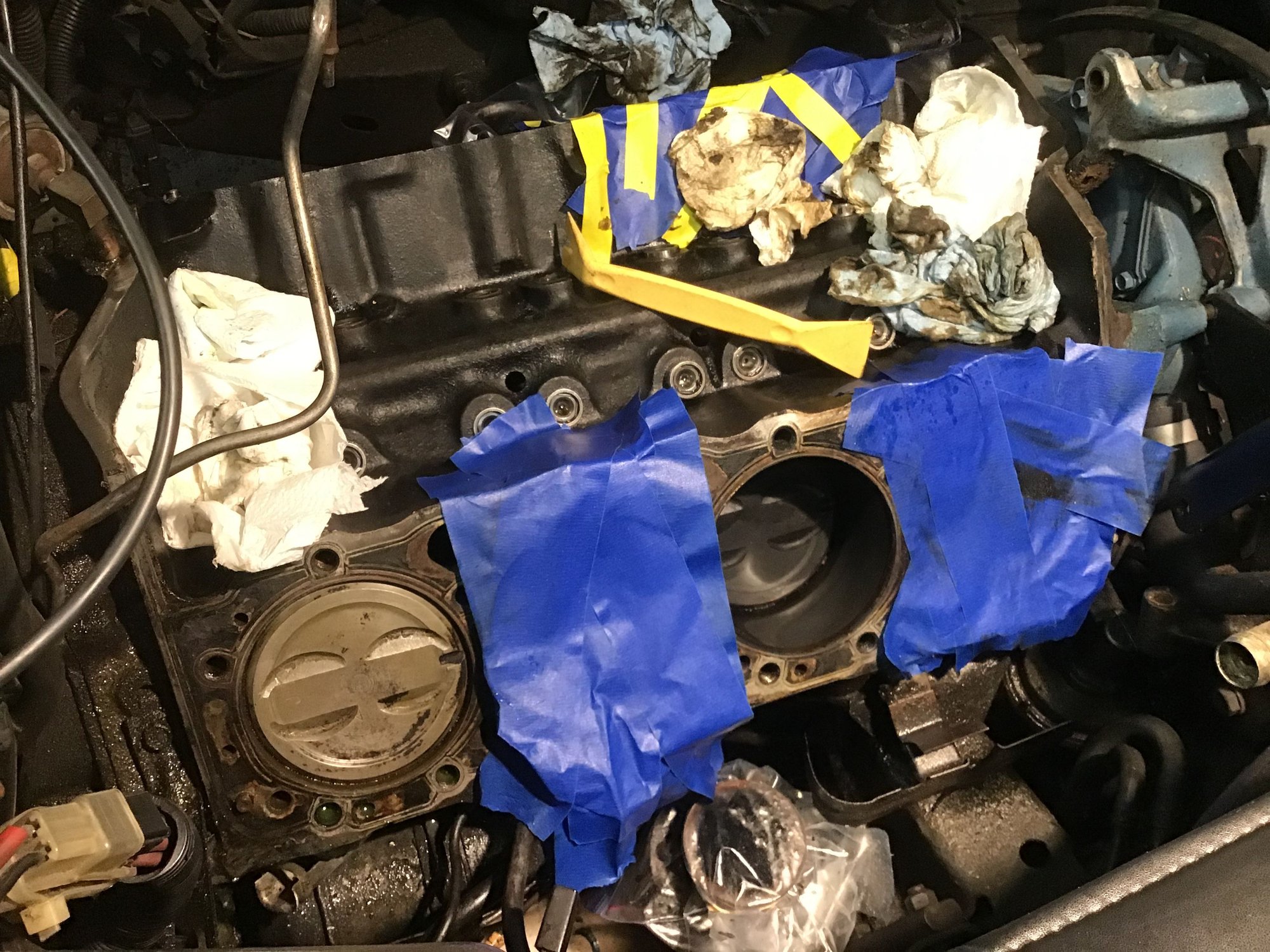

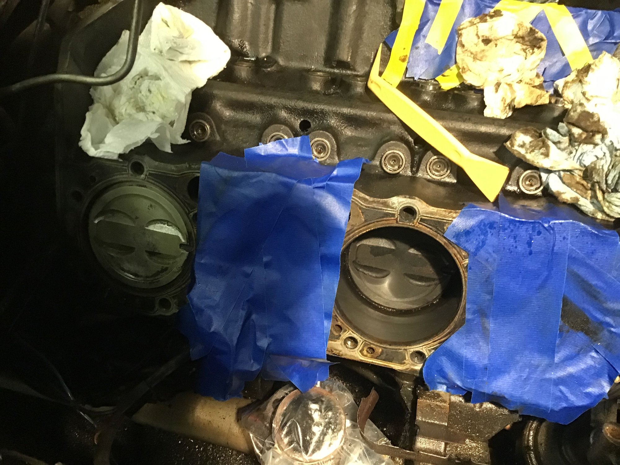

Slow steady process,but they are coming alone great.
Old Mar 17, 2022 | 08:15 PM
Golferdad's Avatar
Golferdad
Joined: Feb 2022
Posts: 988
Likes: 183

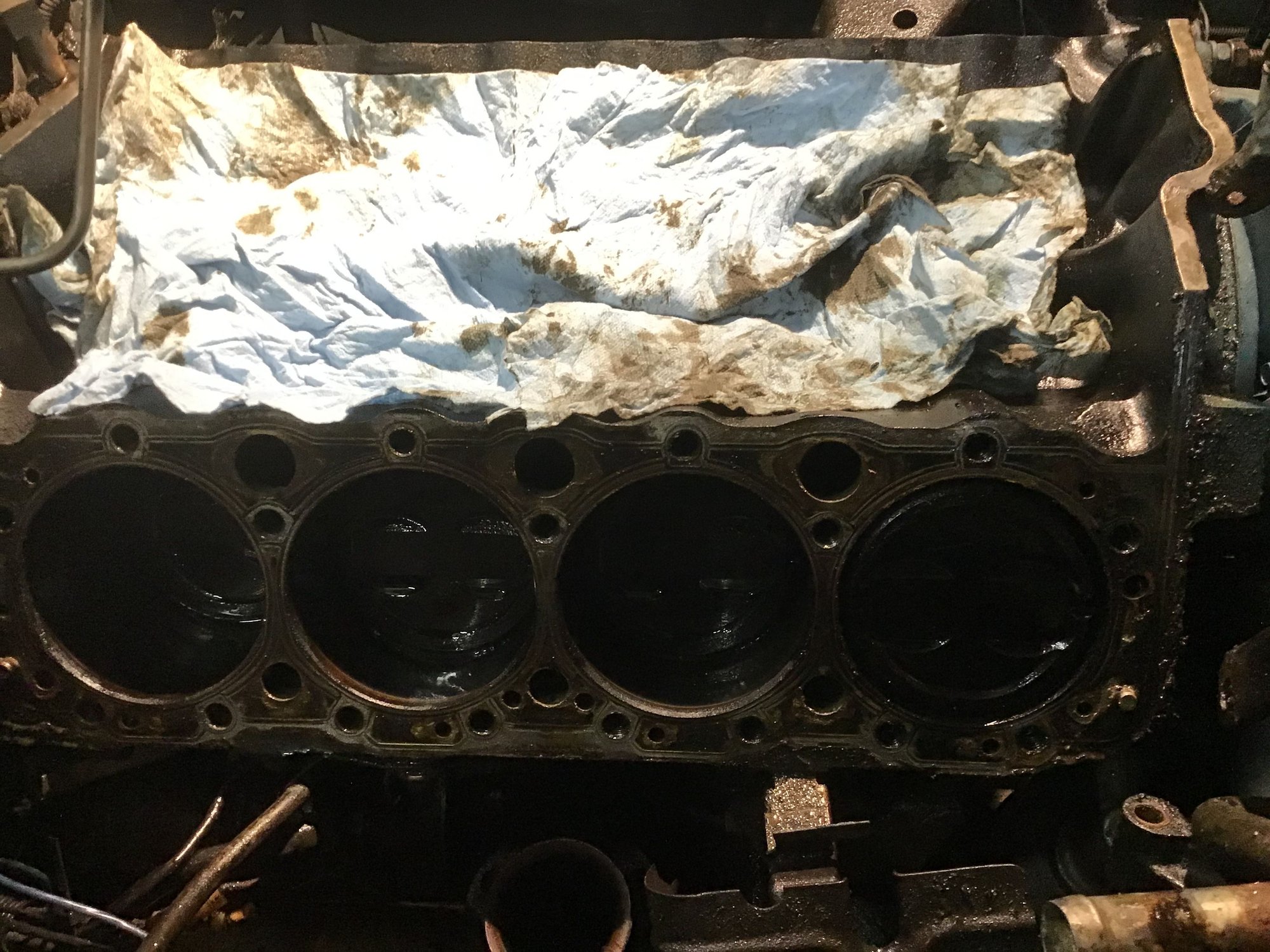

All the pistons came out 👍.

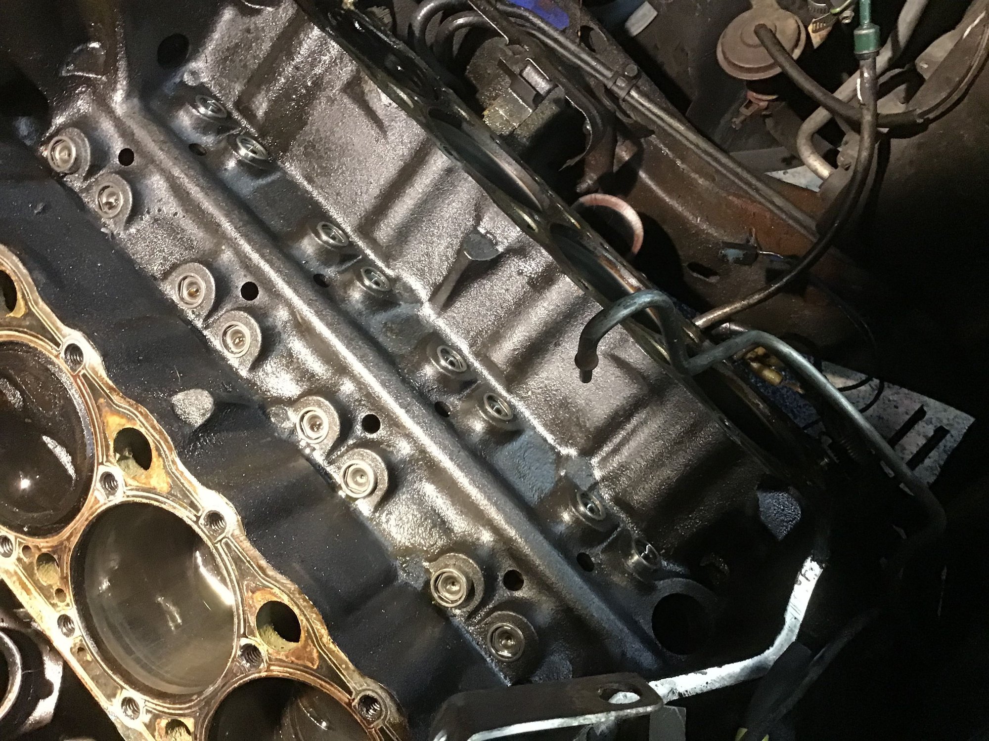

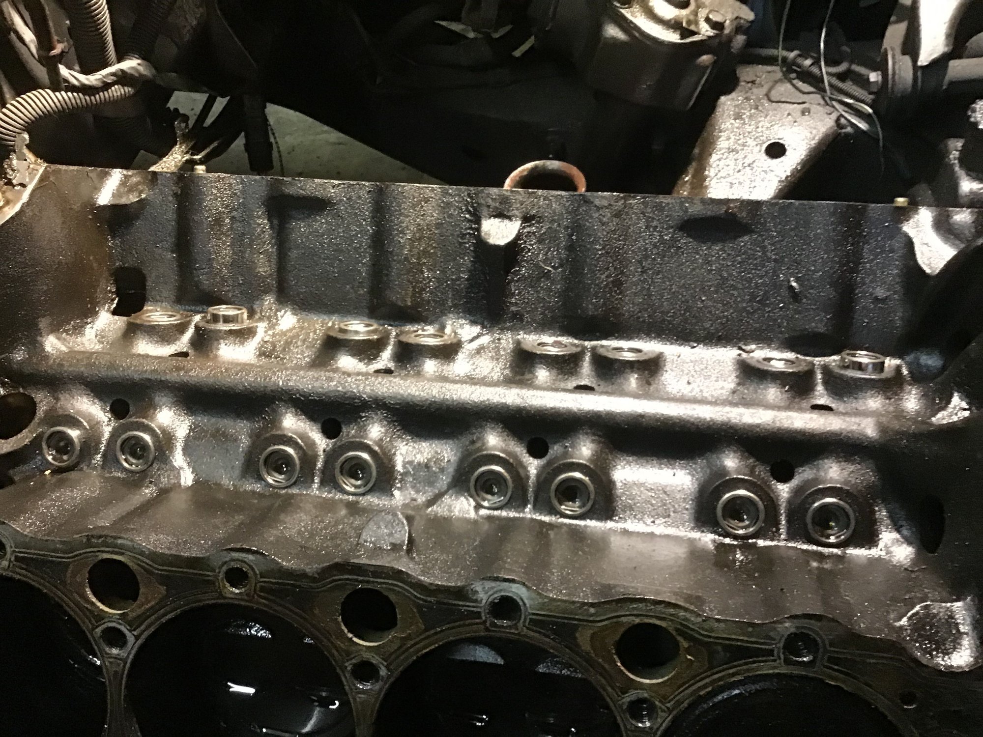

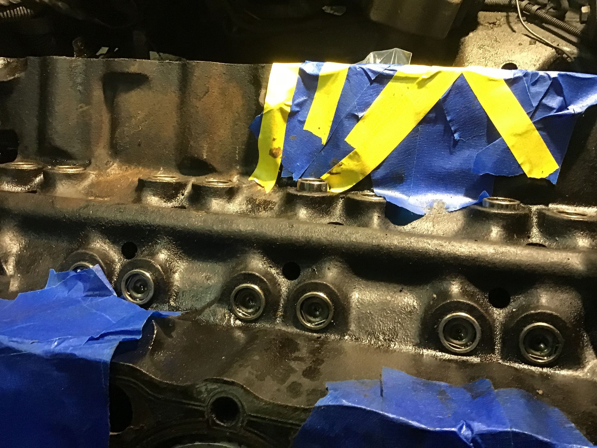

Originally Posted by Golferdad
Now buy the discs I mentioned above and do the decks.....there is no better product on the planet for this.
A well placed shirt in the lifter gallery and lots of compressed air when finished are the order of the day.....

I will.

Yea,I ordered some,but mine are white,I think like 120. Not sure what the greens are.
