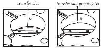

Old 4779 Holley double pumpers had brass sight plugs on the bowls. You adjust them so fuel just barely dribbles out then lock down the adjustment. If you have non removable sight glass like the newer versions you want to set the level in the middle of the glass.
If you have those floats set right, you want to set the transition slot with the idle speed screw. I suspect this is your issue.
This is where the transition slots need to be set.
You really need to set up your ignition curve first before messing with the carb. They work together to solve this problem you are experiencing.
