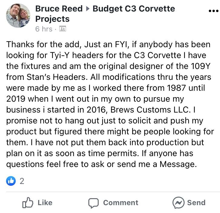

FWIW, this was posted elsewhere yesterday by Bruce Reed
"FYI, if anybody has been looking for Tyi-Y headers for the C3 Corvette I have the fixtures and am the original designer of the 109Y from Stan’s Headers. All modifications thru the years were made by me as I worked there from 1987 until 2019 when I went out in my own to pursue my business i started in 2016, Brews Customs LLC.
M
M
Glad Sean let him join over there and make the announcement! -I connected Sean and Bruce to see if he'd be able to join and make an announcement under the rules over there.

Old Jun 2, 2022 | 08:40 PM
wwiiavfan's Avatar
wwiiavfan
Joined: Oct 2020
Posts: 1,566
Likes: 574
From: Wisconsin
… from Facebook.
