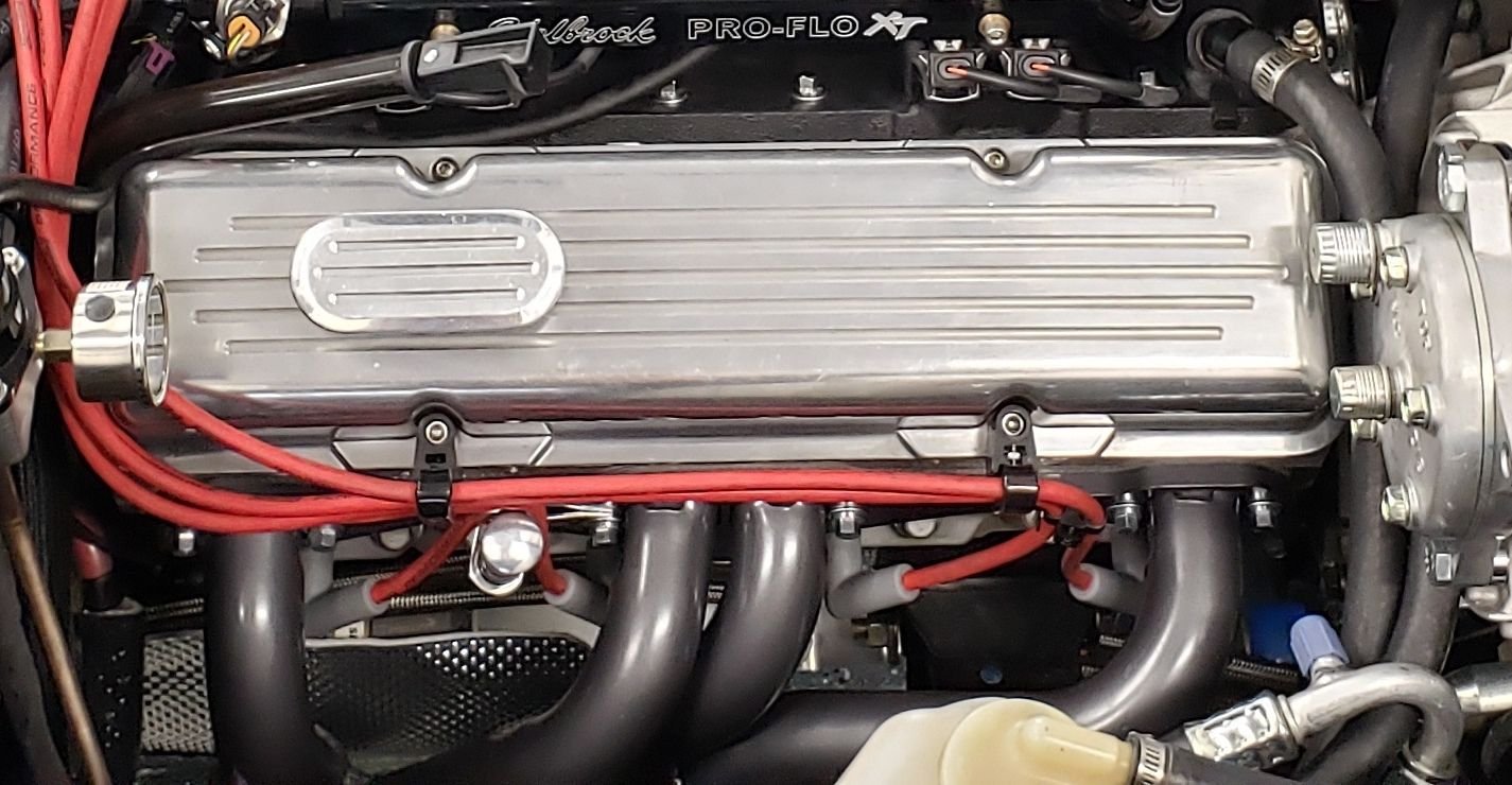

This is the only pic I have at the moment.
You can make out the lines behind the headers. I don't know if this was easier but based on the lengths of the lines that came with my 4L60E kit, it was the best option for me.

Thanks. Those pics would be great. Do the rubber coated clamps bolt onto the oil pan?
No, I didn't use any oil pan bolts but can't remember where I did use the clamps. Seems like there was a threaded hole in the block I could use and one on the front cross member. I do remember having a threaded bolt hole on the side of the transmission where I could place one of the clamps. I'm pretty busy this weekend but if I catch a break, I'll see if I can verify the clamp locations and maybe get a few more pics.
