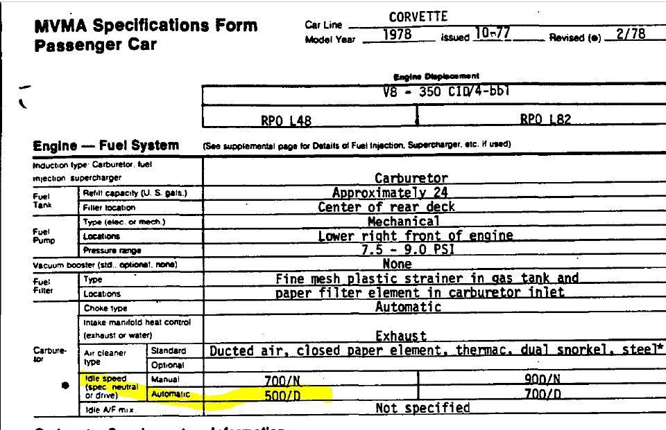

Default Does this help?

900-1000 idle speed? That's way too high bro. 600 is a good speed for a stocker.
^^^^^ This. Way too high of an idle speed so of course it will slam when shifting from idle to a driving gear. Fix that first.
