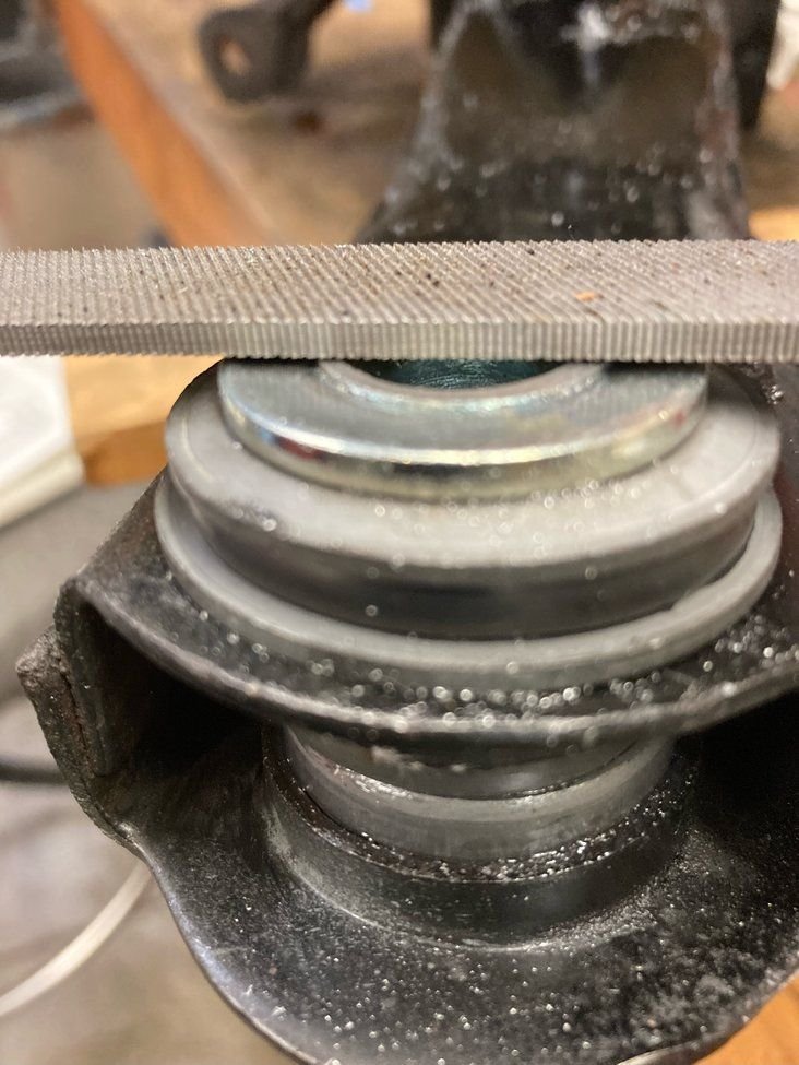

any pics of the bushing? Sometimes when compressing it may not be flared all the way and theshims ride high..
post 20

Unfortunately no photos and i did not pay attention to this. I guess in pulling out the shims this weekend to check.

I'm taking the shims out this week end to look at the bushing. If ok, i'll be doing what you did plus bring an extra set of shims to make the alignment shop happy.
