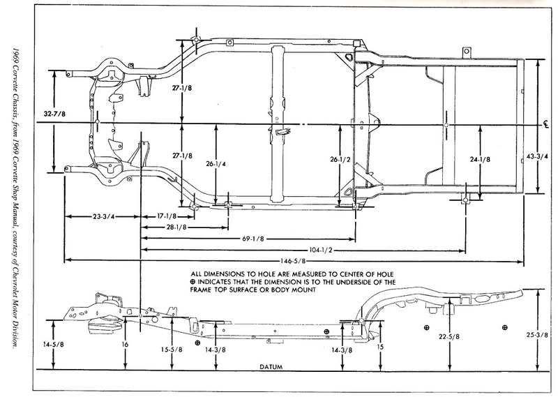

Here are a couple of documents you'll need.
Z & D heights tell you a lot about the condition of the springs due to the ride height. J & K help some too.
Check the Z height attachment, it is 3 pages from a service manual.
File Type: pdf
Thanks Leigh. The engineer in me loves this.
