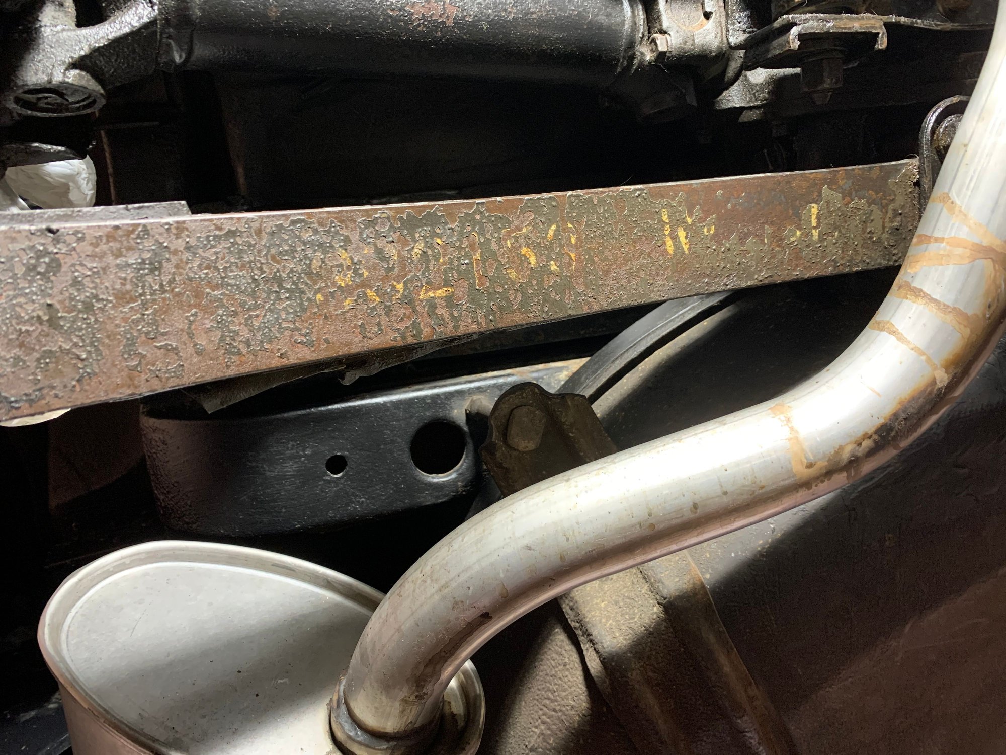

It appears that a previous owner of my 72 installed a service replacement 10 leaf spring 362153 for a 76-77 Corvette. I’m thinking that even though it’s not original to the car, the ride height is nice so I’ll rebuild it. Curious if anyone has pics like this with the numbers more clear? And also wondering about where to get replacement liners. Seems all kits are 9 leaf. I need some schooling. Thanks in advance.

A low-arch composite spring from VanSteel (or NOS from VB&P) isn't original to your car, either, but is 45 lbs lighter!

I have had good luck at
https://www.eatondetroitspring.com/findmyvehicle/
you can call and ask them for the spacers if none of the sponsors have the right one.
i would double check the width of that spring as well. Is there spacers at the plate for 2 1/4 spring?
what are you going to rebuild? Just the liners? What liners are there now? Some were zinc some plastic..

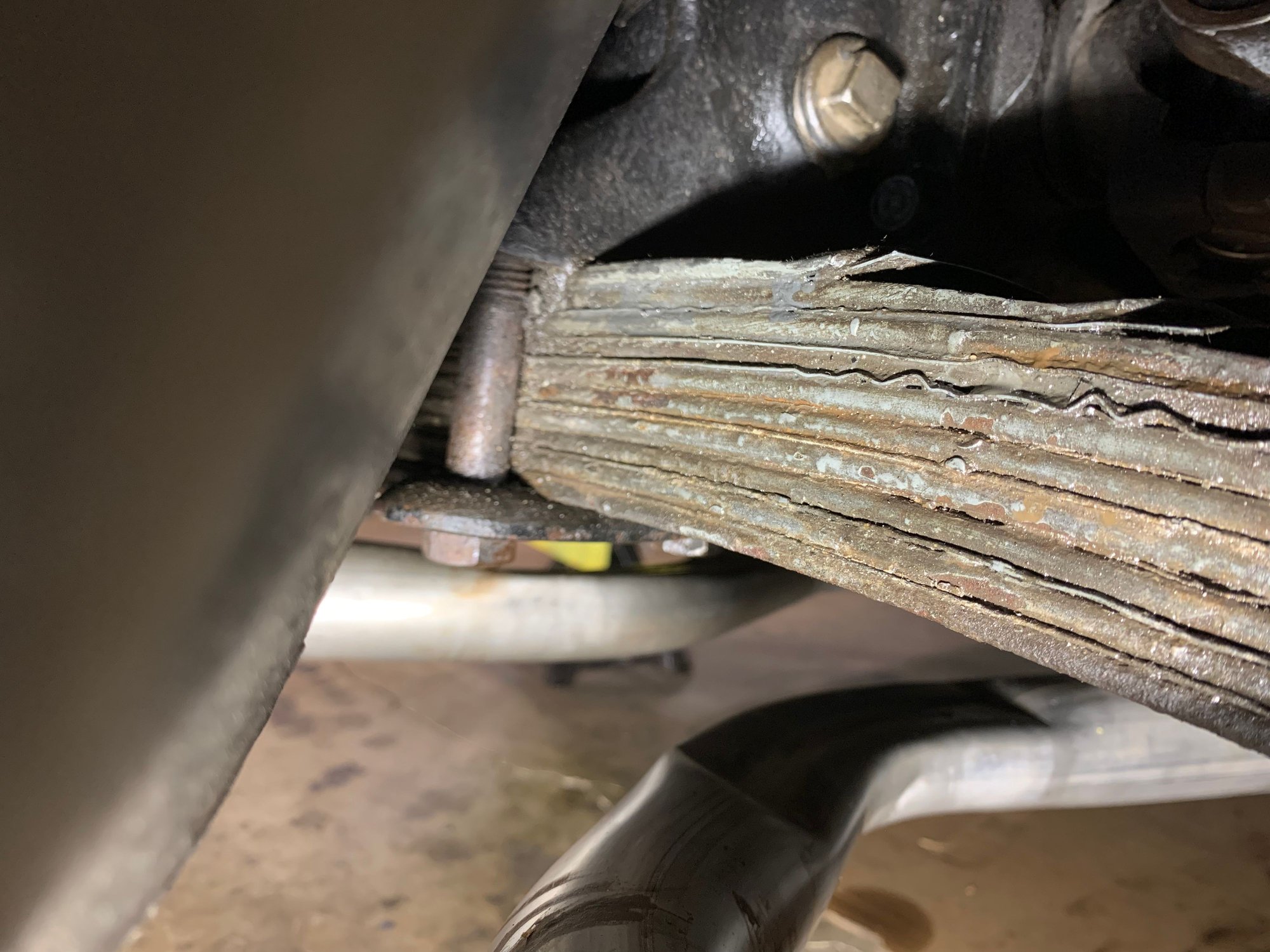

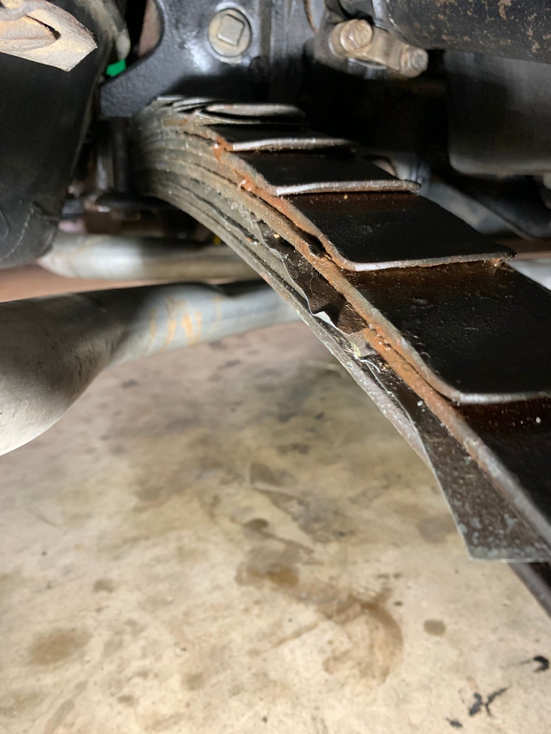

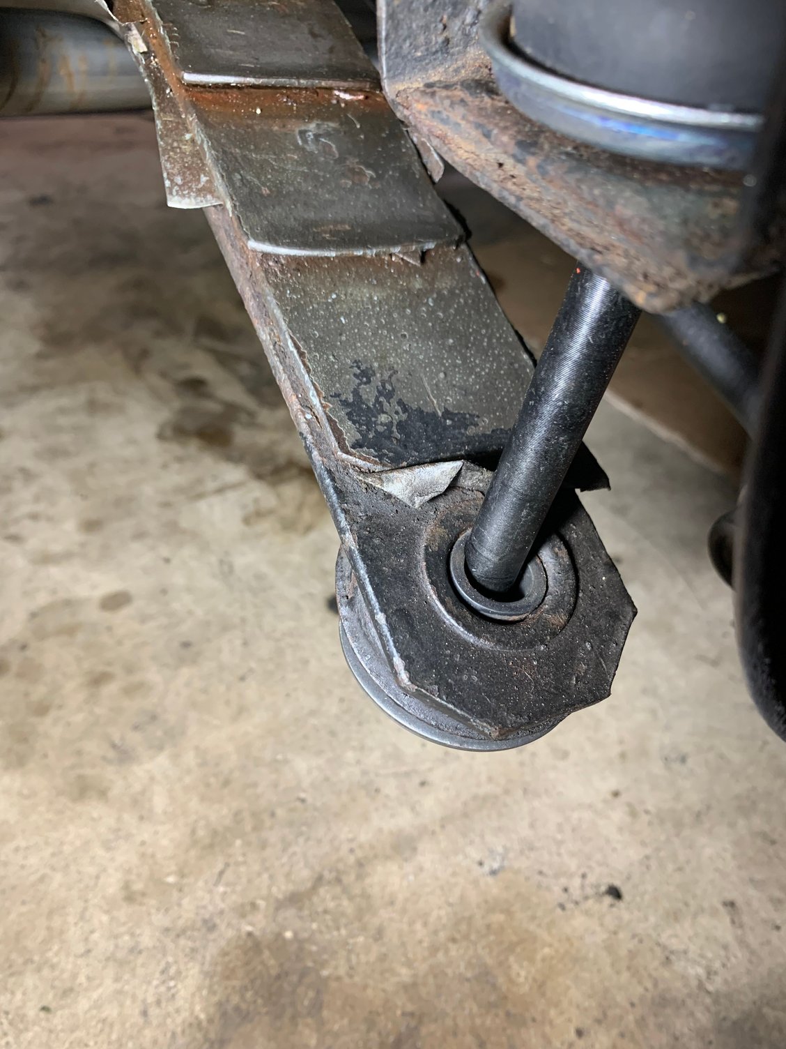

Here’s more pics.

very clean car!
it looks like those are zinc not plastic. I am not sure where you would find those. maybe Eaton can help there.. if plastic can be substituted.
if you like the spring and no issues squeaking, ride, height etc..
- leave it, it looks like a real oem type replacement spring.
- take it apart, replace bushings (which look good) , check cups paint and reassemble with zinc OR plastic liners?
- replace it (insert choice here)
Very curious to what the answer is on zinc vs plastic..
i also use black brake lube (safe for plastic) in between springs/ liners
