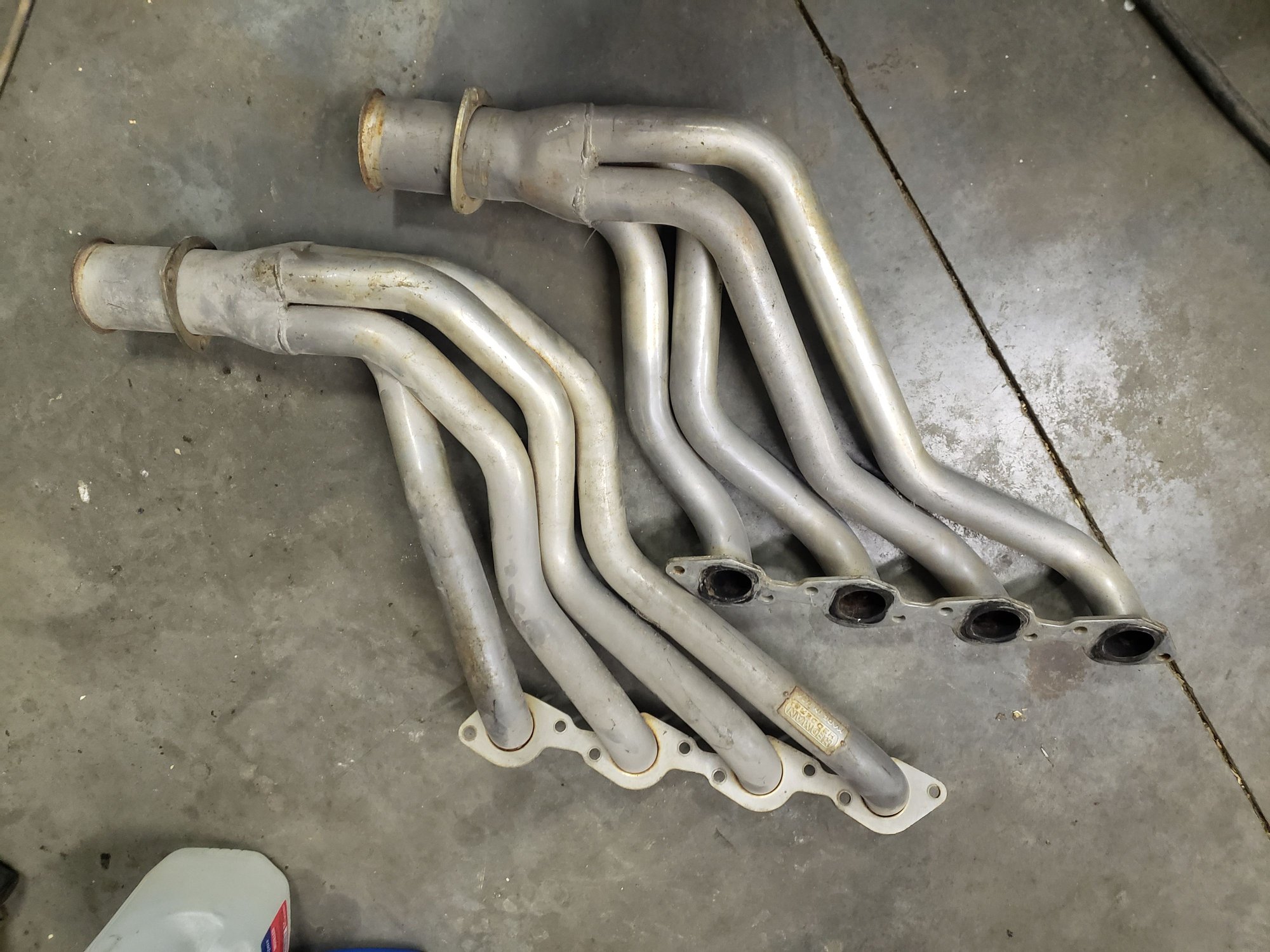

I have a 68 that was originally a bbc car, but I bought it as a roller. I have a good 427 and several sets of bbc headers - most without part numbers. Looking at photos online of early vette bbc headers, the hedmans i have look like they should fit with some massaging. Can anyone tell me if these look like headers you have used in a bbc 68-73 vette?

I have been using Hedman headers on my early 1968 for decades without any issues. I never had to massage them to get them to fit. In fact they just bolted right on and never had any issues. Just get the right set and you won't have any problems.
