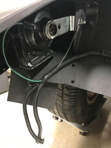

That picture of the 81 horn location is WRONG! At least it was for my 81 built in St Louis. MY horns are WAY out to each side in the fender area. You can barely see them by opening the hood and in that area between the hood and the bumper you can see the wire to one of them. Reach up in there and you'll feel them. I was able to get the wire off one and hook up a test light. Then I could see that they were getting power when I hit the horn button.

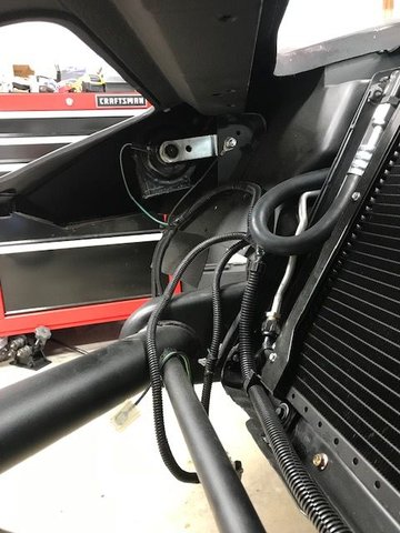

Here is where they are located on my 81, nowhere near what the assembly manual shows. They are pretty well hidden. There are two horn, one located on each side of the car.

Early 81's have one horn mounted on the support near the top center of the area behind the grill, and the second horn mounted on the front bumper support (much like the illustration in the link above). Later 81's have both horns mounted behind the grills, but moved outside of the headlights, more or less in the area behind the parking lights, if that makes sense. I think the change took place around May or June 1981, about the same time production started in Bowling Green. A friend has my 81 Assembly Manual, so I can't describe exactly how they're mounted, or check to see if there is a date for when the change took place, but I know St Louis 81's have been seen with both mounting locations, while Bowling Green cars all have the later, outboard mounted the horns.

My 81 was built Nov. of 1980 so it's fairly early and they are way out in the fender as shown by MattoonVette. With the headlights installed they are hard to find.
