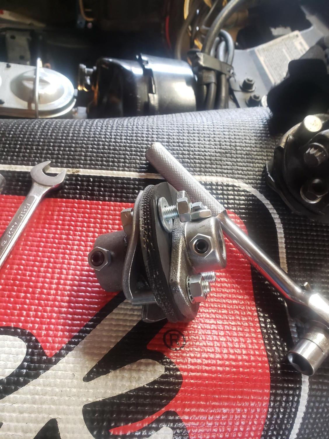

Question 2: I saw a CF thread where the guy used the factory part of the rag joint that goes on the column and connected it to the opposing Borgeson part, is that ok to do? If so, I think I like that better as it goes on easy, and I can lock it down on the factory flat area vs. somehow having to file the column for the Borgeson set screw.

I used the original column side rag joint bracket on mine, as it was MUCH easier to reinstall on the shaft.
You will, however, need to drill out the 2 factory holes in the original bracket to accept the larger diameter bolts on the Borgeson rah joint. Easy peazey.

Thanks for that info. I compared the two side by side and they look the same dimensionally. So I'll just have to drill out the holes in the factory piece. Nice

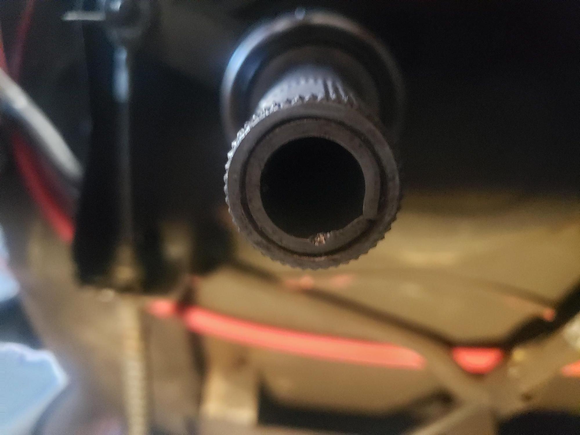

I tried the wire wheel, but it didn't help. I called Borgeson, spoke to a tech, Gil, explained the fitment issue and he said if it didn't go one easily then he suggested using a flat file on the splines. I told him the factory column part of the rag joint went on easily and asked if that could be used with the Borgeson rag joint part that's on the box and he said yes. That's what I ended up doing. Thanks for the feedback.

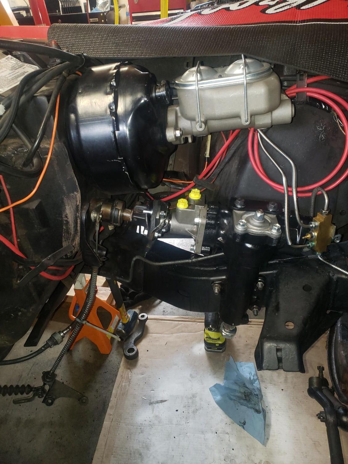

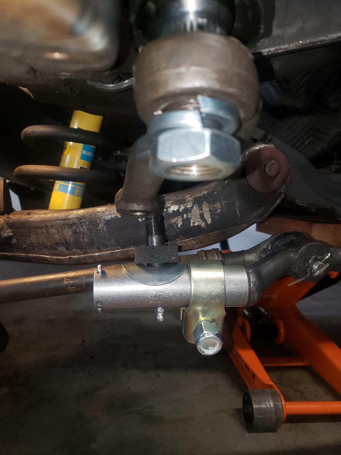

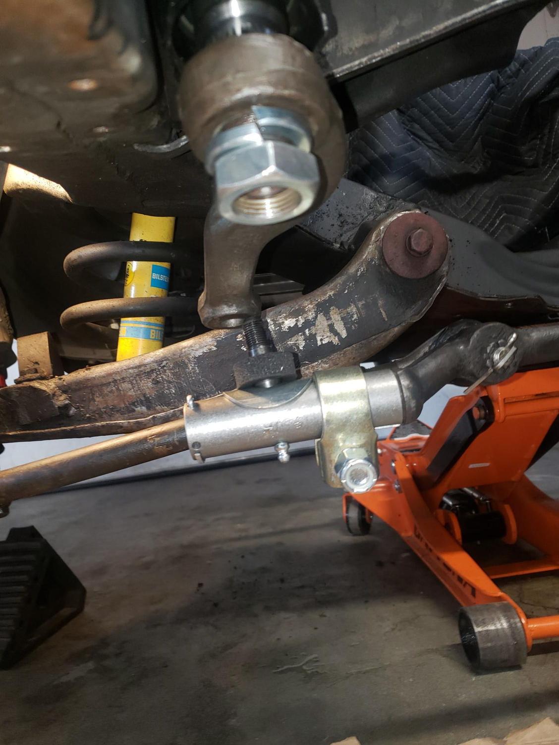

So today I got the Borgeson steering box in the car along with the Ridetech bracket. I ended up using the factory rag join on the column and matted it with the Borgeson opposing part on their box. I did call Borgeson about the fitment issue with their column piece and the tech suggested using a flat file on the splines. He also said it should be ok to mate the two rag joint pieces like I ended up doing. However, I now have an issue with reinstalling the pitman arm to the drag link adapter. It's off by about 1/2" or so. I had asked the Borgeson tech about clocking the box to my already centered wheels with regards to how many turns it took and he confirmed it was one and half plus a little more as lock-to-lock it 3 turns a just a bit more. I didn't confirm, but my guess is they come from the factory centered. Anyway, the difference with the "bit more" might be what I'm off or you have to use their rag joint column piece as it can go on in any position but getting that done it a bit fiddly it seems. I guess I could just turn the wheel and adjust out the end links eyeballing for straightness then take to the alignment shop?
If anyone has suggestions on how to resolve this otherwise, I'm all ears. Pic of course.
Borgeson Steering Box installed
Ridetech Bracket
Pitman arm to drag link alignment off
Another pic of drag link to pitman arm

The pitman to drag link shouldn't be an issue, there's plenty of adjustment in the tie rod ends to correct that.

Exactly. Make sure the box is centered, and bolted to the centered steering wheel. Then adjust the tie rods to track straight. You can lengthen one, and shorten the other the same. Even better, take it to get aligned after. Even betterer, follow @cagotzmann's DIY alignment method.

I did some writing a while back. Definitely use a wire wheel on the column to get any rust or debris off the shaft / splines. Be sure the end of the shaft is not flared slightly. I polished the end / tip of mine with a file.
